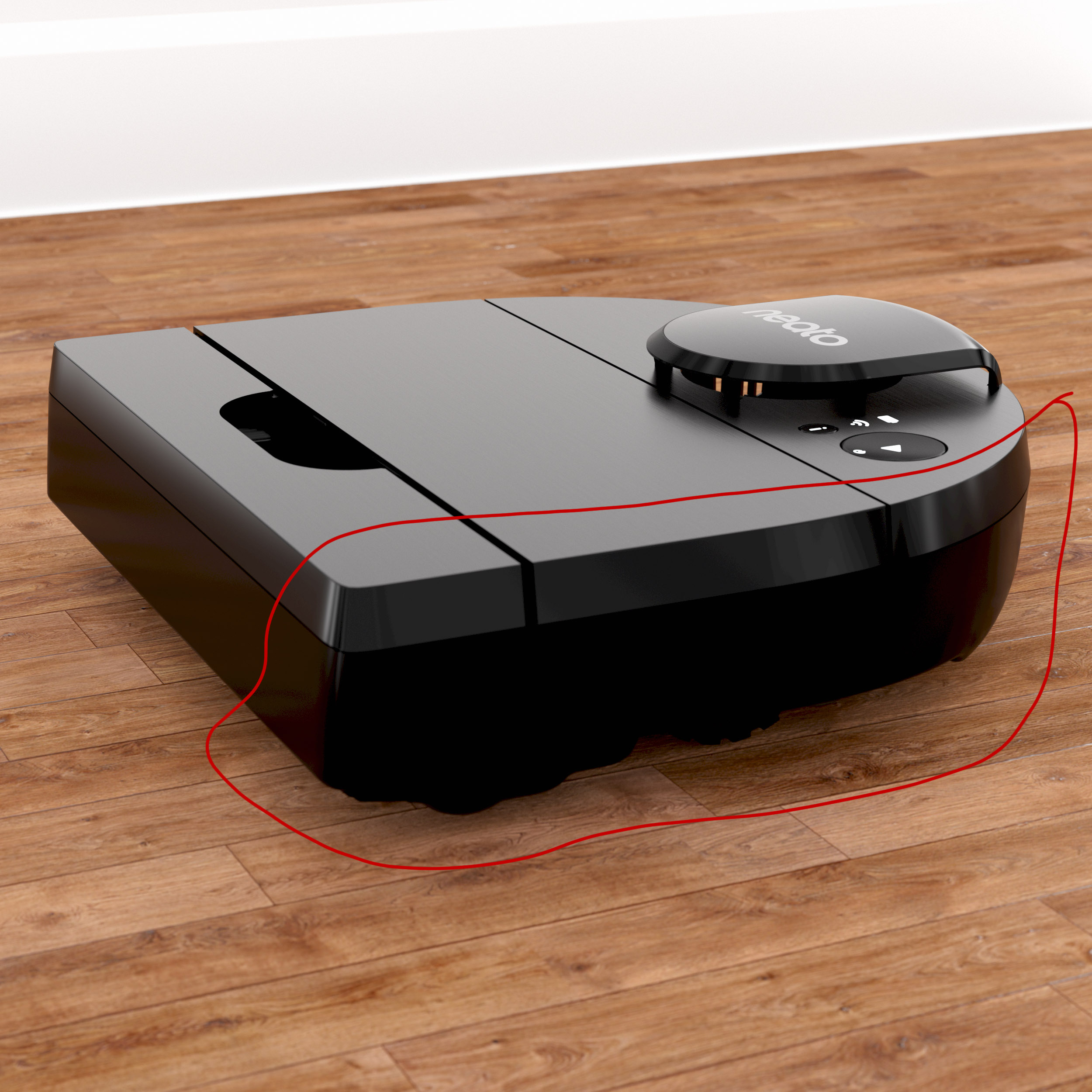

Hi All,
Im having some problems with strange shadow banding and general weird results in dark areas on several different projects. In the frame buffer, the shadows look perfectly fine, and when I save them out, they show the strange banding problem. Does anyone have a guess as to why??

Paride, take that image and flatten it. Youll instantly see the banding better. I can see the banding on that image as I type. Not only that, the shadows are much darker than in the VFB.
I am also getting this exact error on another project. I am ONLY getting these errors in the newest plugin, again more banding, shadows extrememly dark, shadows separating.
Ive used Octane for since it was released, and Ive never seen this error in any of the 1000's or renderings Ive created.
Re: Shadow Banding and Strange Shadow Behavior
Posted: Wed Sep 22, 2021 12:12 pm
by brianzero
And, even in the most simple test project, Im getting banding. This same banding is not seen on the Octane VFB.
Max file attached. Open it, render it, save it, and see if the error persists? Could this be a GPU driver error on my end?
Posted: Wed Sep 22, 2021 1:48 pm
by brianzero
These setting seem to fix the problem, thanks Paride. My question is to the developers, why set the LDR as 'Default Active Viewport' when it creates problems like this? If I save any file when the LDR mode is enabled, the results have errors. Why not have HDR 'viewport mapping tone' set as a default?
It took countless hours to figure this out. I recommend strongly that the developers set HDR as the default value in the next release.
