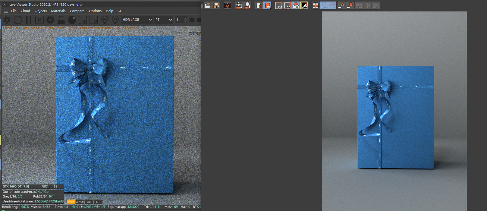

My 3090 is using the C4D S24 live window and the rendered picture, the two are very different, using the lower version of R23 OCTANE 2020.2.3 no problem, is there a problem with my rendering settings?My 3090 is using the C4D S24 live window and the rendered picture, the two are very different, using the lower version of R23 OCTANE 2020.2.3 no problem, is there a problem with my rendering settings?

Can't you find what you did wrong? There may be several reasons that may cause differences. Not possible with this unsufficient information.

我也遇到了这个问题。
新版本实时渲染器和最终效果一样,是显卡太老了吗? 我用的显卡是GTX1660。
希望有人能解答这个问题

Activating any pass will cause linear display profile for PV viewing since render passes don't have seperate display buffer. Saved image will be correct with current case, not displayed
