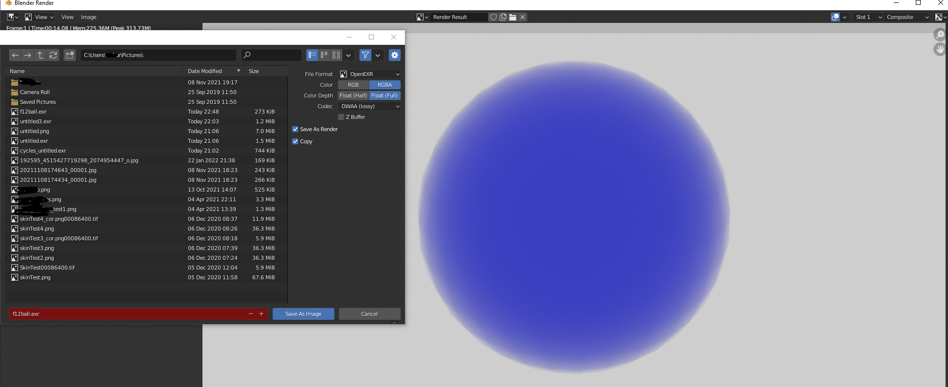

If I save the file via Octane Output, I get a correct EXR but this method seems to be prone to overwriting. Every time I hit F12 to render, I will be overwriting the saved EXR.
F12 Render -> Image -> Save As -> OpenEXR, I get an EXR with Filmic Log Encoding already applied.
F12 Window
F12 Window
Side by side comparison
Comparison
Comparison
I want to save the sRGB Raw via Image -> Save As while having Octane Camera Imager(Preview Mode) display the Filmic Log Encoding in the viewport, how can I do it? Sorry for resurrecting an old thread.

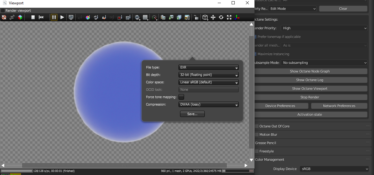

edit: A workaround I've found is to open Octane Viewport and save the EXR directly from there, although Octane Viewport doesn't seem to work in 2022.1 XB1.

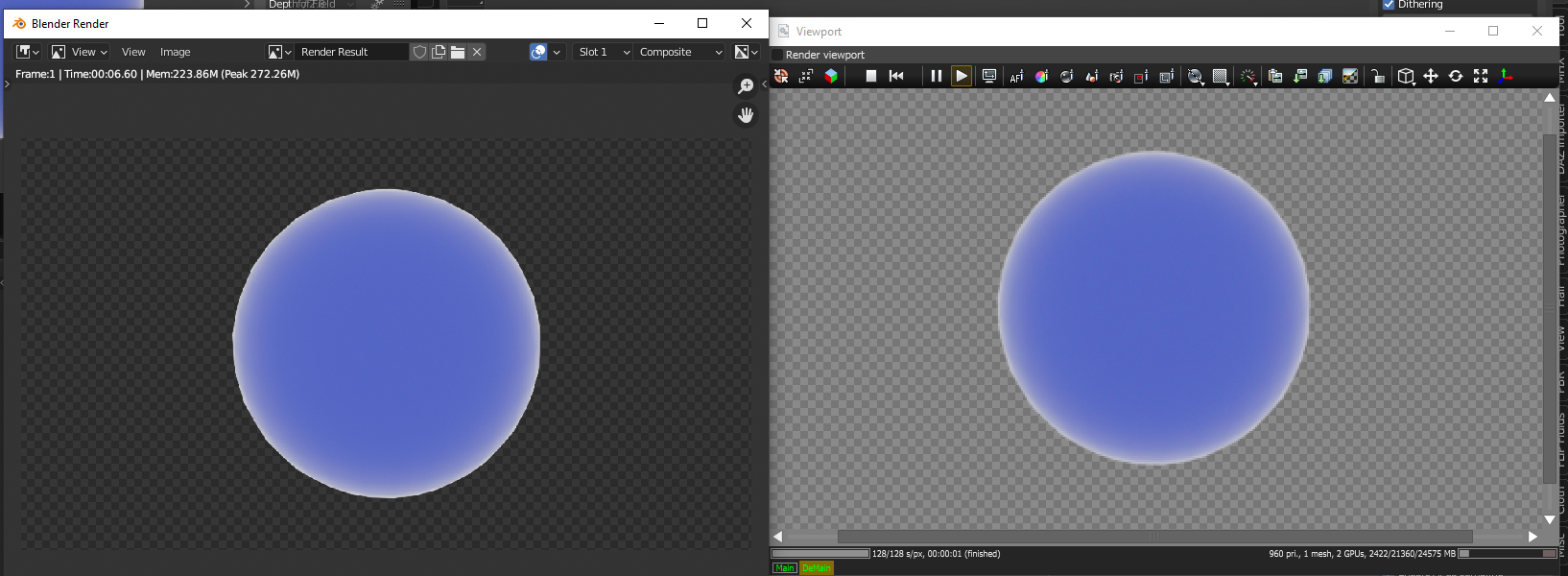

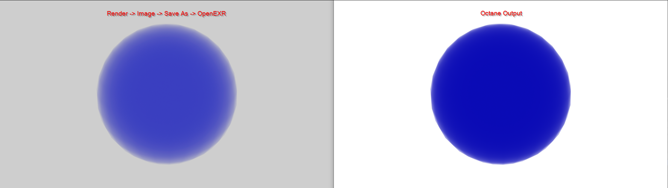

I'm sorry but I may not be understanding your comment correctly. I already have my color management set up as described in your blog. My issue is that saving an EXR through blenders (F12) Render -> Image -> Save As -> OpenEXR gives a different image than saving the EXR via Octane Viewport or Octane Output.
The Viewport, (F12) Render view and the Octane Viewport render all show the same image.
EXR Saved from (F12) Render -> Image -> Save As -> OpenEXR
EXR saved from Octane Viewport
My goal is to have an EXR saved from Blender's native render window be the same as an EXR saved from Octane's viewport window in Linear. Just to avoid any confusion, by Octane Viewport I mean the "Show Octane Viewport" found in render settings.
