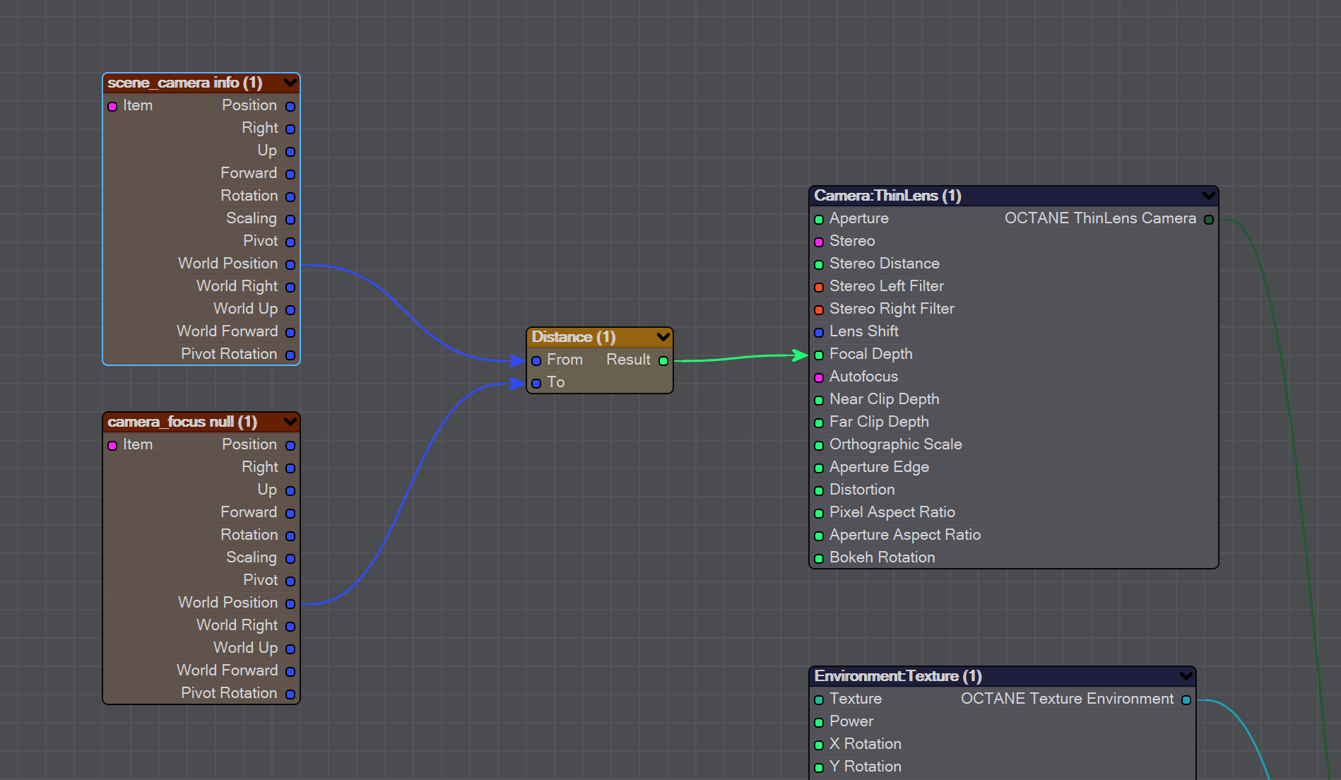

OK, now I have a slightly different problem: I have a shallow depth of field in a scene I'm working on, and I want to manually rack focus (i.e., I'm not using autofocus). The ThinLens camera doesn't have an envelope on the "Focal Depth" setting (which is really focal distance) though, so there doesn't seem to be a way to keyframe the focus at various timings in the scene.
I know you showed a scalar node going into the Focal Depth input on ThinLens in the Render Target editor, but that's just a static value that stays the same for the entire scene. How would one go about keyframing focal distance? Thanks.
Re: Focal length motion blur; keyframing focal point; help docs?
Posted: Mon May 03, 2021 9:04 am
by tombosschaert
Use a distance node from camera to a null?
Posted: Mon May 03, 2021 1:53 pm
by scooternva
^^^ That's what I thought of too, but what do you plug into the "From" and "To" inputs on the Distance node? The Render Target editor (which is the context where you use the ThinLens node) sits above all of the other objects and items in a LightWave scene, so how would one go about getting the motion information for the camera and the "focus null" into the Render Target context?
ETA: Oh good grief, I feel like an idiot now. I sometimes forget that just because Octane can't access LightWave's instance information doesn't mean it can't access LightWave's ITEM information, which is a completely different thing:
Just remember to use world position for your camera and your focus null or you will get some... interesting results.
