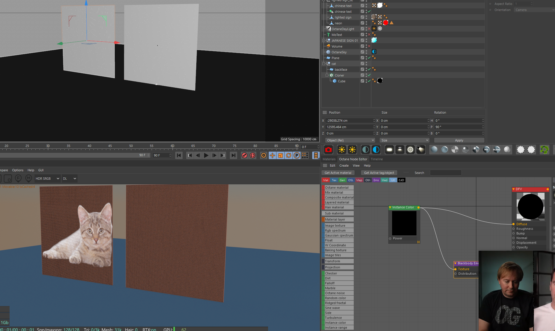

Hi, Have been having issues with the instance color with cloner. Everytime I duplicate a copy of it the image on the last cloner dissapears.
I've tried changing the image making them two separate image but it does nothing. Is there a limit to it??

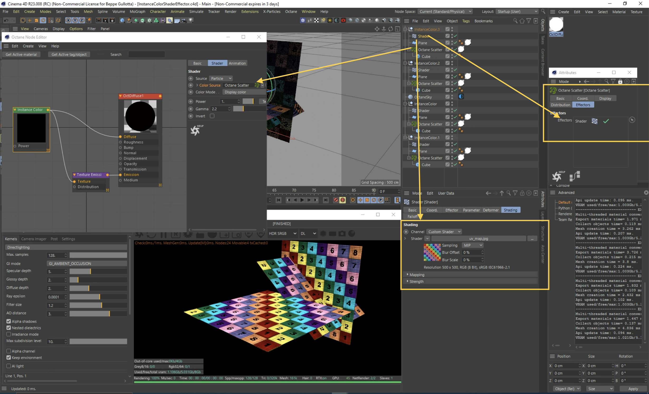

you can use the Color Instance node in Particles mode, with the Octane Scatter object as source, and a Shader Effector Applied to the Scatter object, in this way you can move it around wherever you want:
