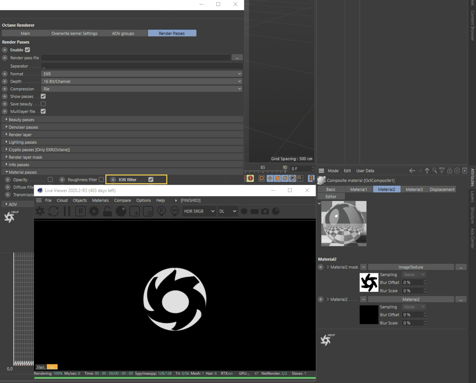

for custom AOV passes you need to wait for the upcoming 2021.1 SDK:
viewtopic.php?f=33&t=76440
For now, you need to use the Take system for creating a special version of the scene with special Composite/Mix material, using the same texture mask, with different IOR settings for the two submaterials, and use the Material pass/IOR Filter to obtain the desired mask:
ciao Beppe

Ok thanks man, i missed that. For stills i have a workaround with the diffuse pass. For animations i will have to render twice then. Thanks again.
