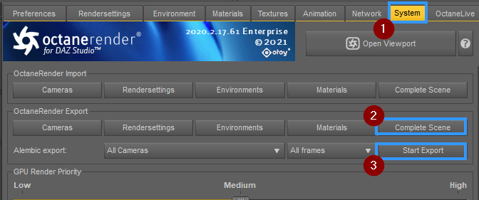

Would it be possible to share a Daz scene via PM?
Ok, but I'm not sure how I can share a full scene with you. DAZ is notorious for not being able to export stand-alone packages that include library assets. Any suggestions?
Hi Jazbee,
Thanks so much for the post.
The *Complete Scene* export would export Octane Standalone single frame ORBX and for animation OctaneRender for Daz only export .ocs as a workaround.
Please use the *Start Export* from the System tab then in Standalone *Save as Package* from the file menu to pack the ORBX scene.
cheers
Kind Regards
bk3d

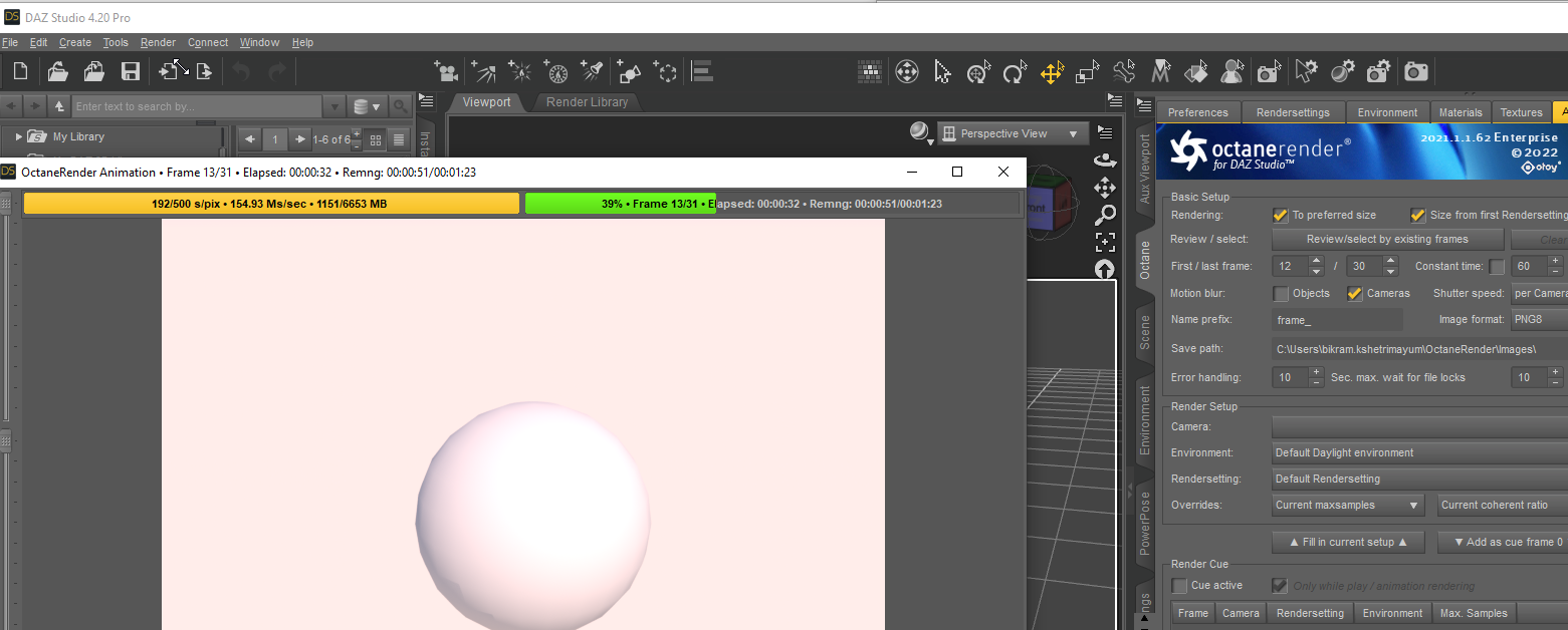

Does this plugin work with Daz 4.20? I've tried installing it multiple times and it still doesn't appear in Daz. I use the Daz install manager for the installation. Any help would be appreciated!

BK
Posts: 1520
mikefix wrote:Does this plugin work with Daz 4.20? I've tried installing it multiple times and it still doesn't appear in Daz. I use the Daz install manager for the installation. Any help would be appreciated!
Hi Sorel,
Daz 4.20 works on my workstation. Please find the screenshot below.
Please try installing with Daz central instead of the Daz install manager!
cheers
Kind Regards
bk3d
