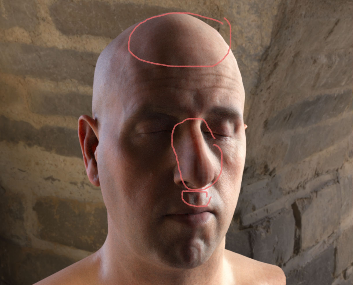

Hi, so this is a huge issue that simply doesnt have an answer, and I've spent months looking for an answer. I always ended up compromising but I have a project that requires extreme realism and I want to figure out what is going on.
So, as was already discussed here, SSS with fake shadows on removes phong angle from model. That results in a heavily faceted look.
Here are the "solutions" that don't really work on the internet:
1. Increase Subdivision Surface - Doesn't resolve faceting, just makes polys look smaller and still faceted. Also, makes scene unreasonably heavy.
2. Increase Ray-Epsilon - This works, but it causes other huge problems. One is that the color of the SSS becomes extremely saturated and dark, and there's no real way to fix it as much as I try to make the color and scatter lighter. Also, It causes ugly artifacts in the small details where objects overlap or are placed close to each other due to the higher ray-epsilon.
3. "Smooth" option on the Common tab in the material doesnt fix it. Messing with the phong tag doesn't fix it.
The only thing that actually works, is unticking Fake Shadows. But then, the SSS requires high scatter depth.
Here's the examples
First I tried to work with the exported DAZ model I have, this has Ray Epsilon of 0.00001 (Needed a lower Ray Epsilon to solve something else in this scene):
After trying endless of different combinations and fixes, I tried to work with a model known to have perfect topology and textures to see if I still get it
Ray Epsilon 0.0001:
Ray Epsilon 0.001 (look at the artifacts where the lips and eyelids touch):
And here's how it looks with no Fake Shadows on ray epsilon 0.0001:
As you can see, the fake shadows cause this issue. Is this a known and unfixable Octane in C4D issue? Because I've seen people get good results without faceting using this technique in Octane on other programs or not using Octane.
Here's how I made the material - Albedo is black and Transmission is on 100.
Any tips of other tricks? Is this simply not the way to achieve highly realistic skin in Octane for C4D?
Should I just use a different approach to SSS that might look less realistic?
Thanks!

Hi, I am not a C4D user but I faced this problem too.
The easiest way to get rid of visible normals is switching to Diffuse mode for Universal Material insted of Specular. For some weird reason, Random Walk SSS and Specular mat fails on Daz3D models (quad topology), BUT at the same time it works for other models with triangle or triangulated topology or non-Daz quad topology.
I have no idea how OTOY test their stuff. The initial implementation of Random Walk has visible UDIM seams on Daz models, now it has visible normals with spec mats on Daz models.
Hope we get a more stable Random Walk SSS in future releases :roll:
