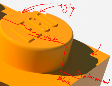

hi!
The whole knob is a displacement. (32bit tiff)
Why do I get those sharp artefacts?

This is one of the limitations of Texture Displacement.
To solve, change the mode of the Displacement node from Texture to Vertex Displacement:
http://www.aoktar.com/octane/VertexDisplacement.html
Please also have a look at this discussion here:
viewtopic.php?f=30&t=74890&start=10#p383708
ciao Beppe

thanks a lot! thx for the hint with vector Displacenten, I always thought I need a "colorfull"bitmat like for "normals" for that.
