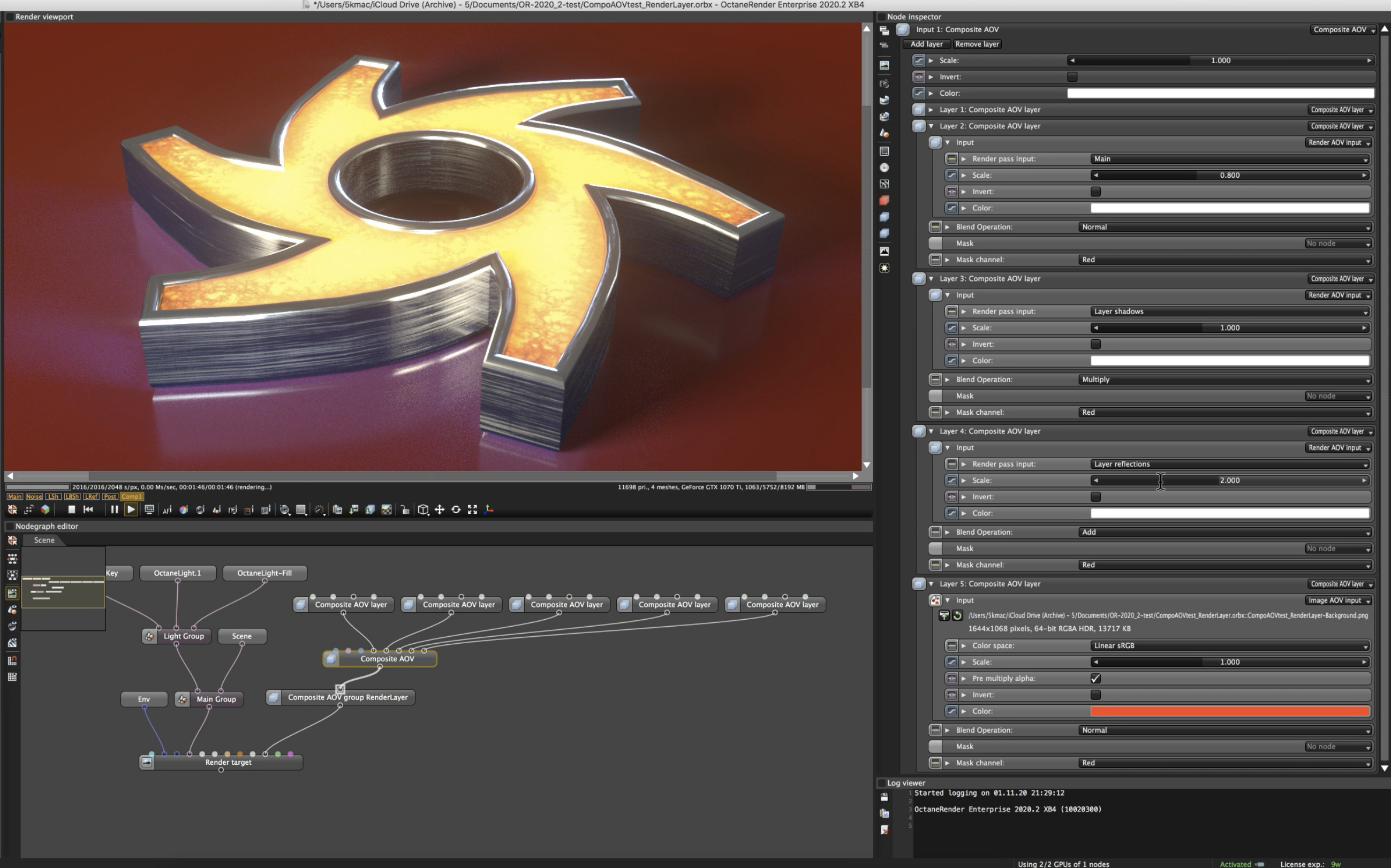

Hi Adam,
please have a look at the Render Layer technique herer:
https://docs.otoy.com/StandaloneH_STA/S ... Passes.htm
In the latest test version, you can create a Compositing AOV node, and compose the Render Layer passes directly in viewport.
