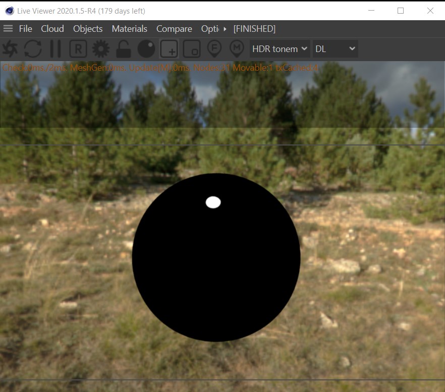

I am trying to create a glass Toon Material. How can I go about this? I am having trouble getting a transparent diffuse with full opacity specular using the Toon Material. I have tried turning off the diffuse channel, but it's just black.
Thank you!

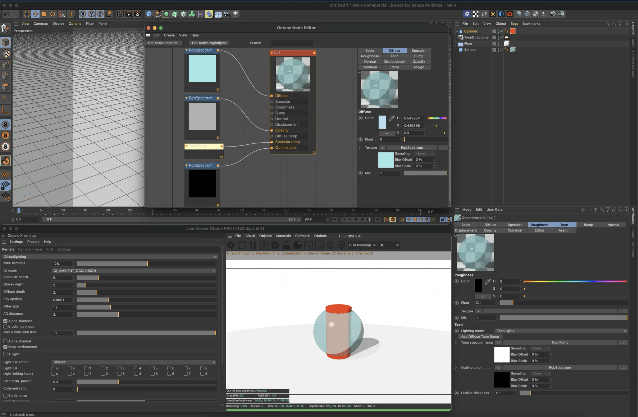

to mimic a transparent toon material, firstly you need a Toon Light for the effect, and you need to set the Opacity at 50%, with Specular Ramp:
ciao Beppe

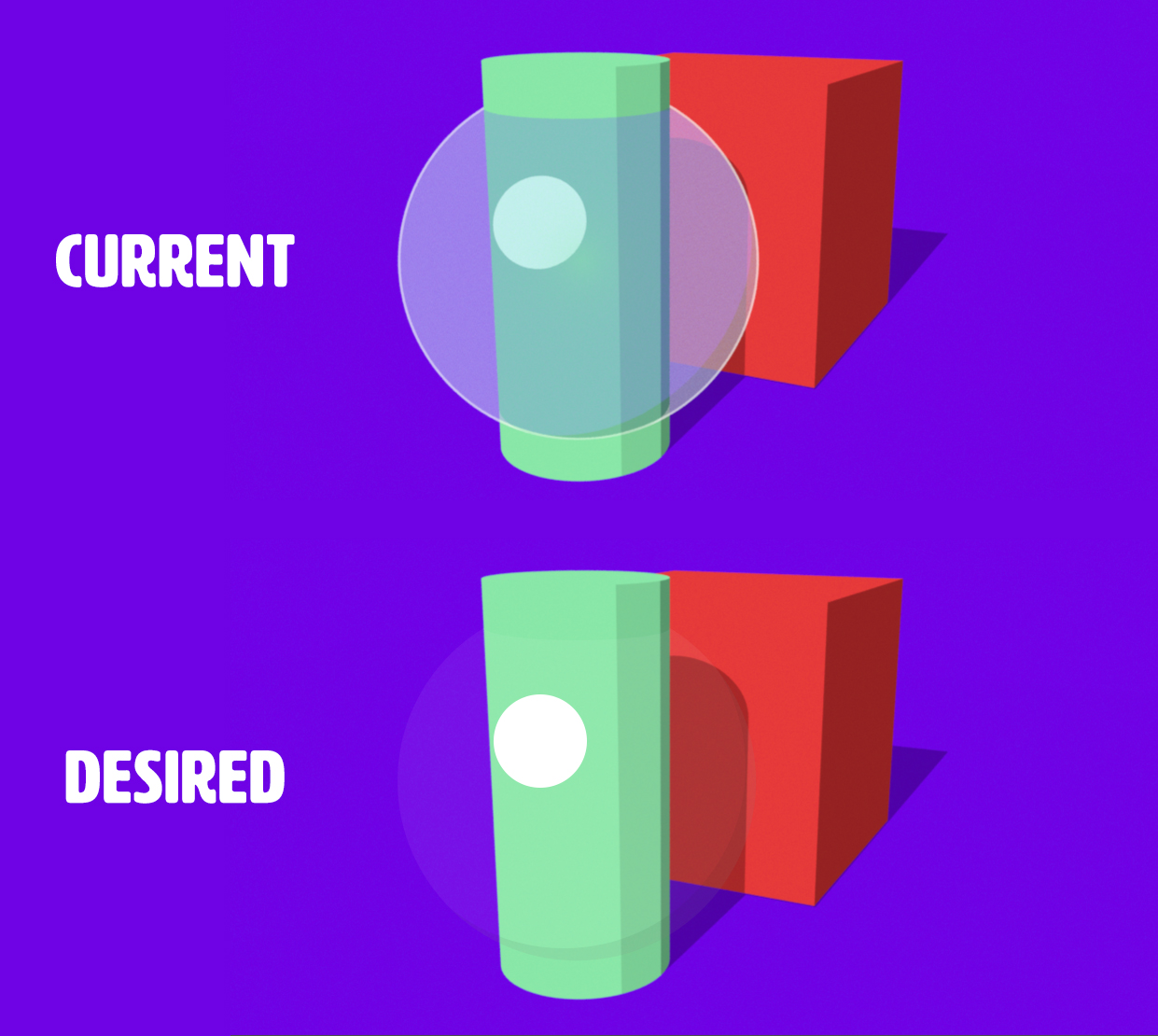

Do you mind to share a screenshot of the result you are looking for?
ciao Beppe
Re: Toon Material Glass
Posted: Wed Dec 02, 2020 4:58 pm
by blastframe

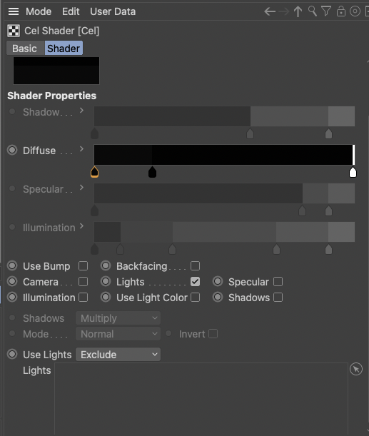

Sure. This was achieved using the Cel Shader in the Alpha Channel of Cinema 4D's Standard Material. The ramp goes from white to 1% black to %3 black. There are two Infinite Lights in the scene. Please note that the Specular is at full opacity. Thank you for the help.

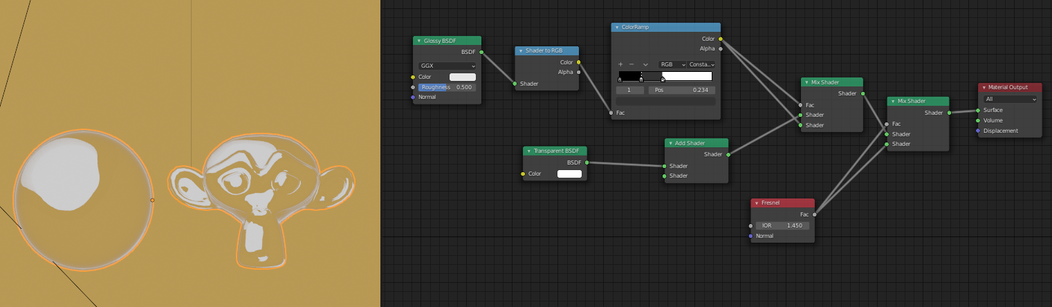

Here is a completely transparent diffuse material made in Blender (from this post):

try to play with a Falloff node in the Opacity channel, and Roughness value:
ciao Beppe
