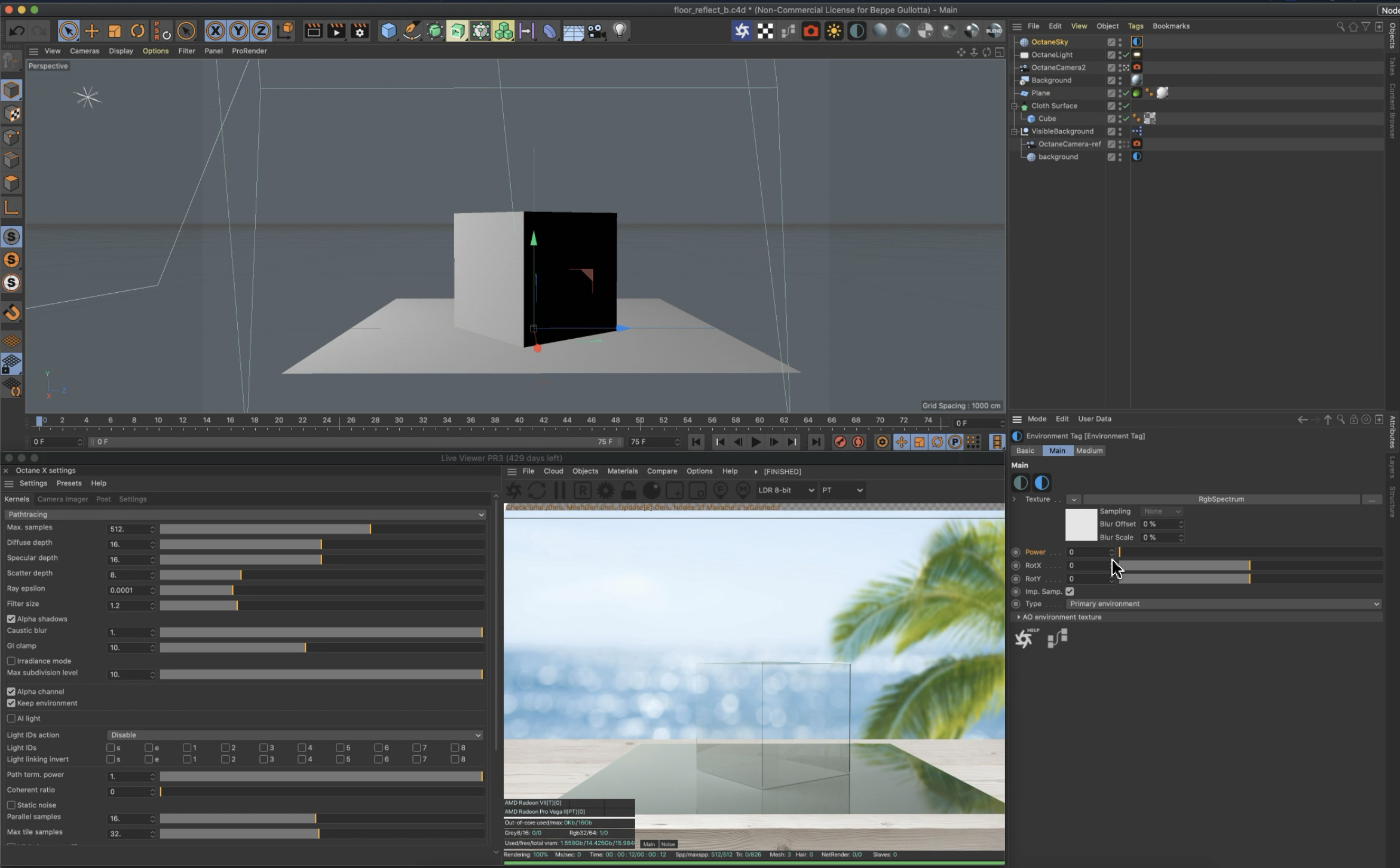

Hi all
I've been looking further into this because I still haven't found what I'm looking for ;-)
Im attaching another file in the hope that I may get an answer. Being still relatively new to octane some out there may know how to deal with this. I have a scene as shown in the screen shot, and im trying to have the object, in this case a simple cube reflect into the floor and also create shadows. I would also ideally like the floor and background image to reflect back into the cube itself. This I know is possible in c4d using the physical render and the comp tag.
I've also seen after GIOLETS shared a brilliant thread below and have also downloaded the visible background file and script but im not sure if im using it correctly or if it can even do what im after? Would bepeg4d know better?
Really hoping someone can help so thank you in advance.

I am not sure to have fully understood your question.
I have enclosed here an updated file hoping to give a little contribution.
1) In order to extract the Shadows of the cube on the plane you have "enable" passes, I've placed an octanetag on the object that I want to extract shadows giving an appropriate Layer ID.
2) in order to have reflections on the cube and the plane:
-I have modified your light (opacity=0 and not visible on specular)
- please note that around your scene you have nothing so the cube faces reflect only thanks to Visible Background script, but not in physically correct manner. The right choice should be to have a 360° background image all around.
Probably I haven't fully understood your question, in that case, sorry for my OT post.

Luca/GIOLETS is right, you have chosen a very particular scene.
Both surfaces are Glossy without roughness.
Here is what happen if you us a Specular material for the cube:
And here is what happen if you add a Black Primary Environment:

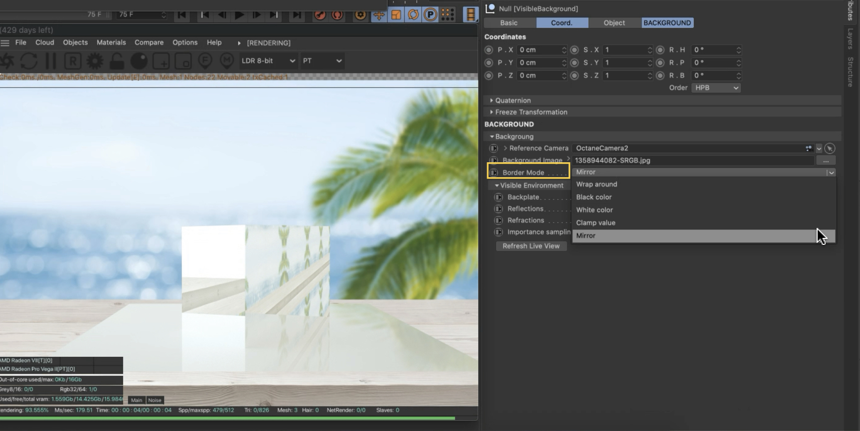

The reflections are controlled by the Border Mode parameter in the Visible environment node:
In Clamp mode, the last pixel of the image is repeated all around, so you are having those reflections, here is what happen in Mirror mode... but as Luca has already sad, better to have a full HDRI as Primary environment.
Finally, here is the reflection pass with Render Layer technique active:
