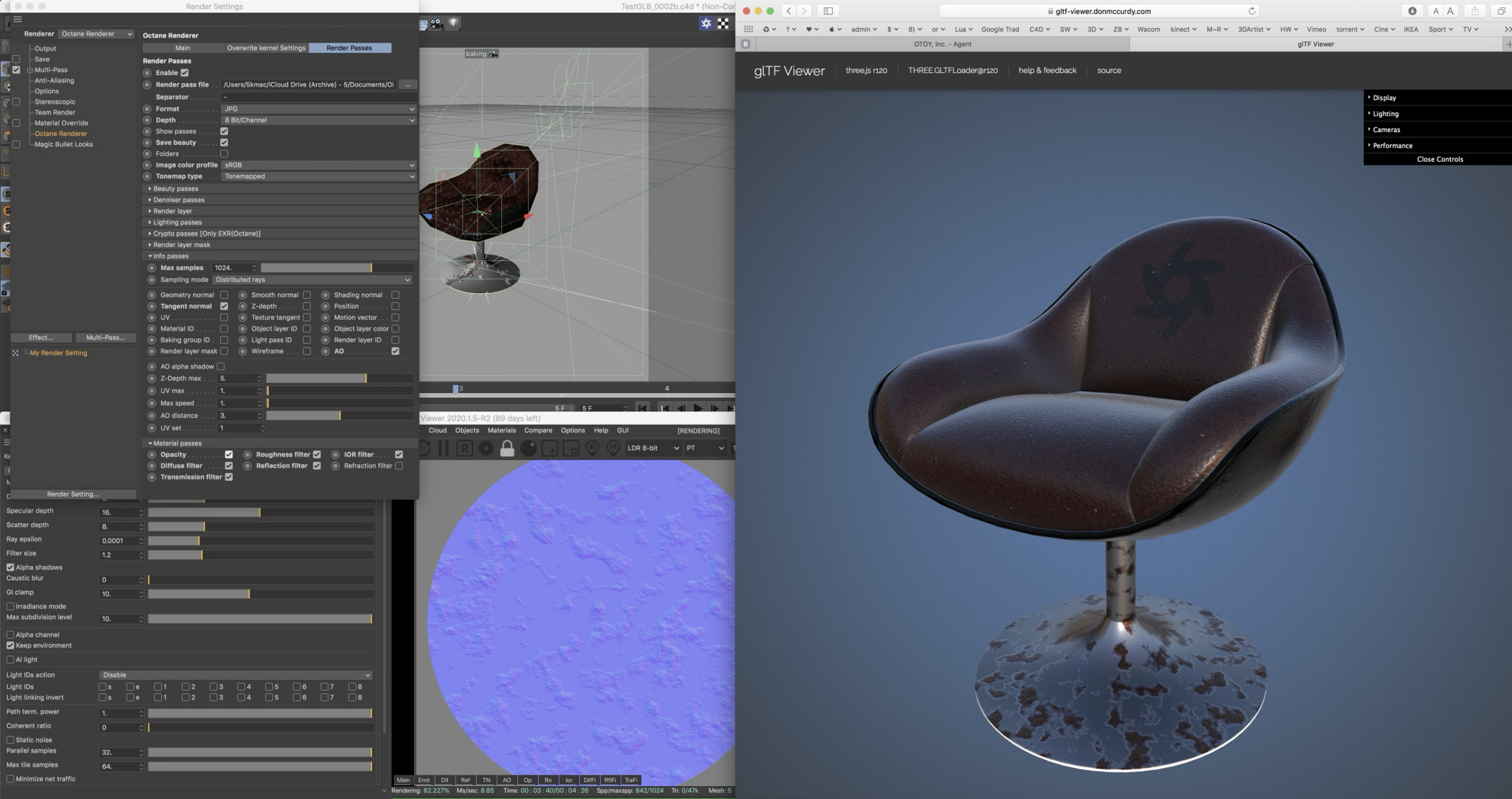

Anyway, I have checked, and if Baking Camera is set correctly, you can obtain very interesting textures to be used with glTF/GLB/PBR materials:
ciao Beppe

Ok, I had a look at your scene, and basically the issue was in the Displacement node, that cannot be baked, so you need to use the texture with Bump, in order to obtain the Normal map, with the Tangent Normal pass, to be used in the PBR material.
