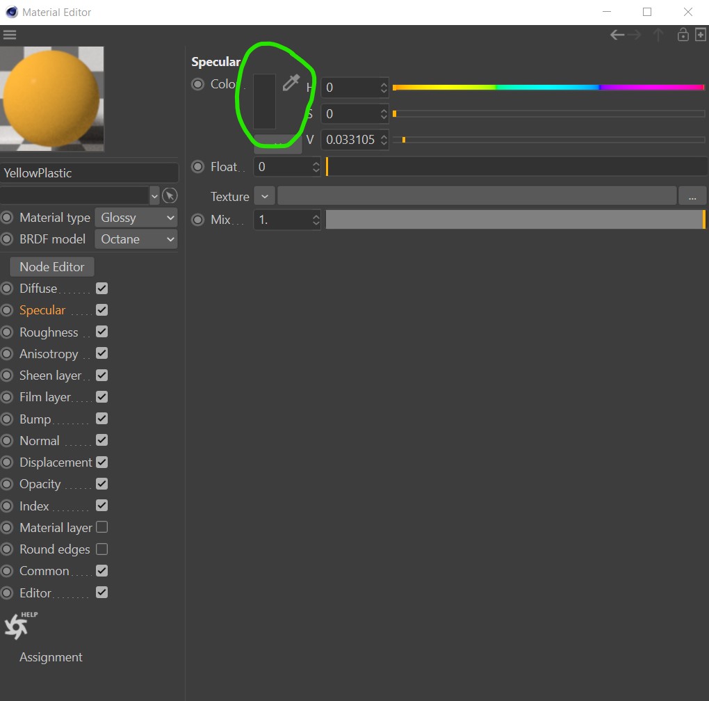

1. Convert Materials produces incorrect values for Specular color:
In a PBR Material with one Reflectance layer, the Layer Color is white. When using Octane's Convert Materials command, the Specular Color is incorrect:
Cinema 4D PBR Specular Color
Octane Convert Materials Result: Specular

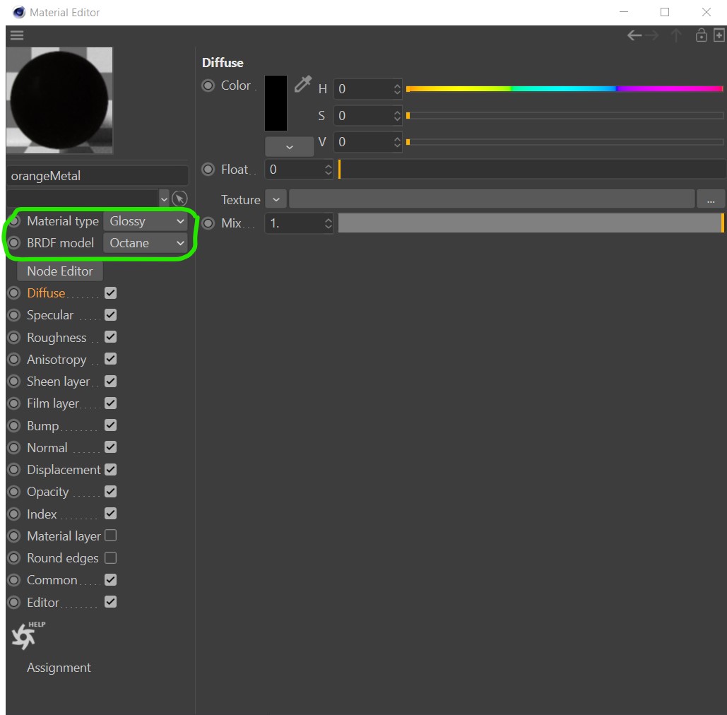

2. Metallic PBR Materials do not use Metallic Octane Materials or BRDF Model
Also, though the PBR Reflectance Attenuation is set to 'Metal', the Convert Materials result does not use 'Metallic' or 'Universal' as the Material type nor the correct BRDF model, so metals do not get converted properly.
Cinema 4D PBR Metal
Cinema 4D PBR Metal
Octane Convert Materials Result: Metal
