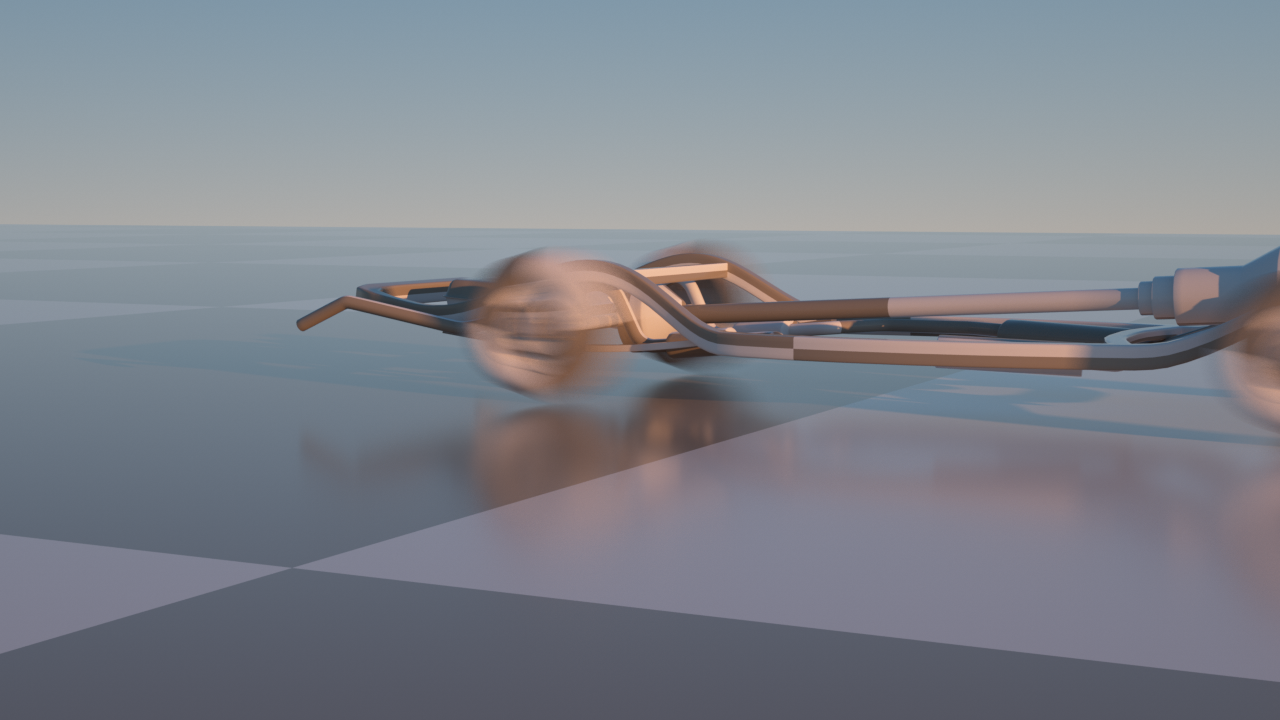

I have a camera attached to the moving object. I'd like to use motion blur, but instead, I have the next issues:
  • • the background is not blurred
    • the car has is blurred
    • the wheels don't blur properly: the tire looks like blurred with DoF (not a motion blur). And the rim isn't blurred at all.
You can see all the settings in the screenshot attached.

I've attached some more tests and the scene file:
car-motion-blur.zip
(614.17 KiB) Downloaded 366 times
Thinlens camera
Thinlens camera
Thinlens camera, focus on wheel
Universal camera: the car is now behind the shot, shifted to the right (it's not my mistake in placing the camera). Also, now the wheels are blurred.
Universal camera, focus on wheel (for this shot I moved camera 160 cm to the right for it to see the wheel)
Expected result (Photoshop)

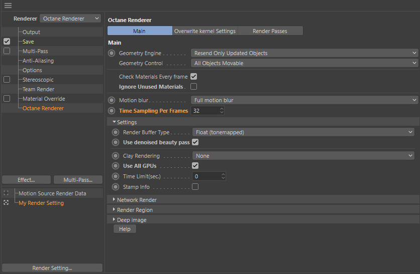

Here are my settings:
render-settings
render-settings

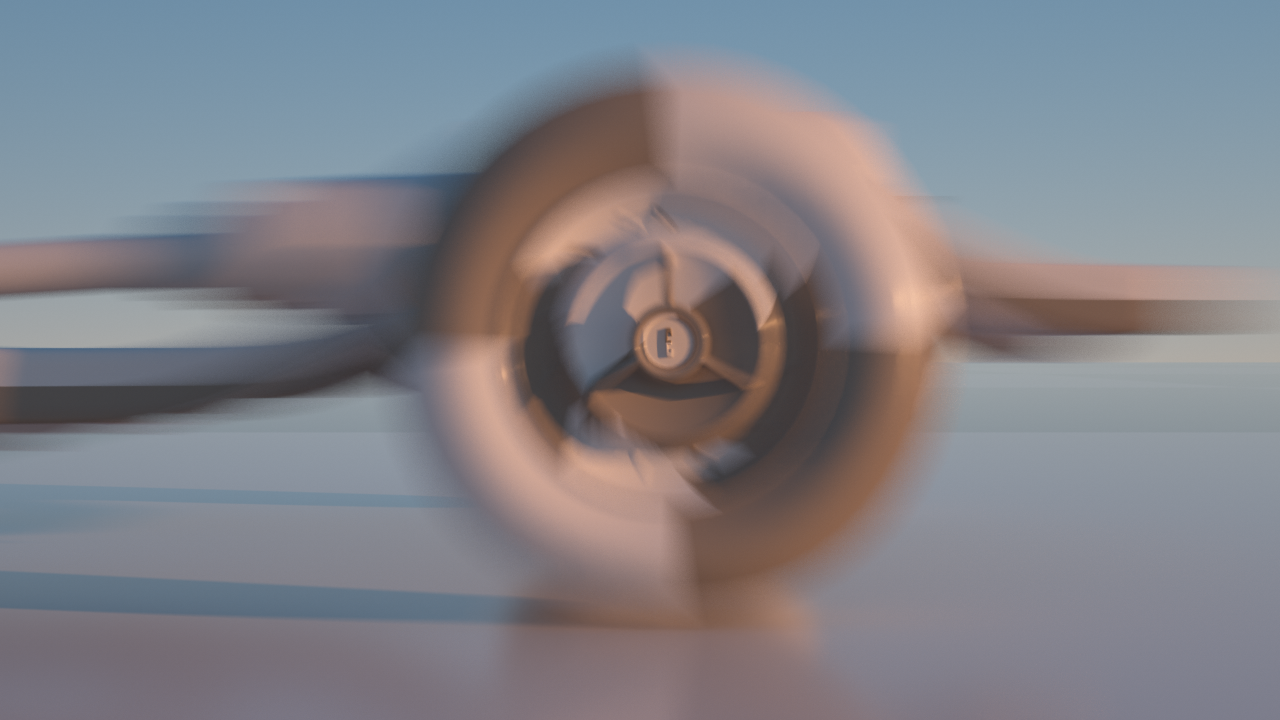

And here is what I get in the picture viewer render:
picture viewer
picture viewer
I even tried to add an object tag with motion blur disabled, but renderer just ignores it.

Re: Eternal Issue: Motion Blur on the Moving Object
Posted: Thu Sep 03, 2020 11:54 pm
by jayroth2020
Hi Aleksey, I would need to see the next scene for a look. If you feel more comfortable filing a ticket at -- help at otoy dot com -- we can keep your assets private.
In terms of RNDR, it is best to run it through standalone first, and I believe that the time sampling rate can be set there. I do not know if the time sample rate was intended to be exposed within RNDR or not. I would have to run that one over to the RNDR team for confirmation.

by aoktar
Aleksei wrote:Thanks for you help, Jay. I’ll create the ticket.
Checked the topic!
The universal camera has a problem with producing motion blur when having PSR keyframes. It looks like CORE issue, thanks for posting it. No need to tickets.
Tested it with ned SDK(2020.1.5), seems like fixed. So mblur steps=10 and new build will give correct results with Universal camera
