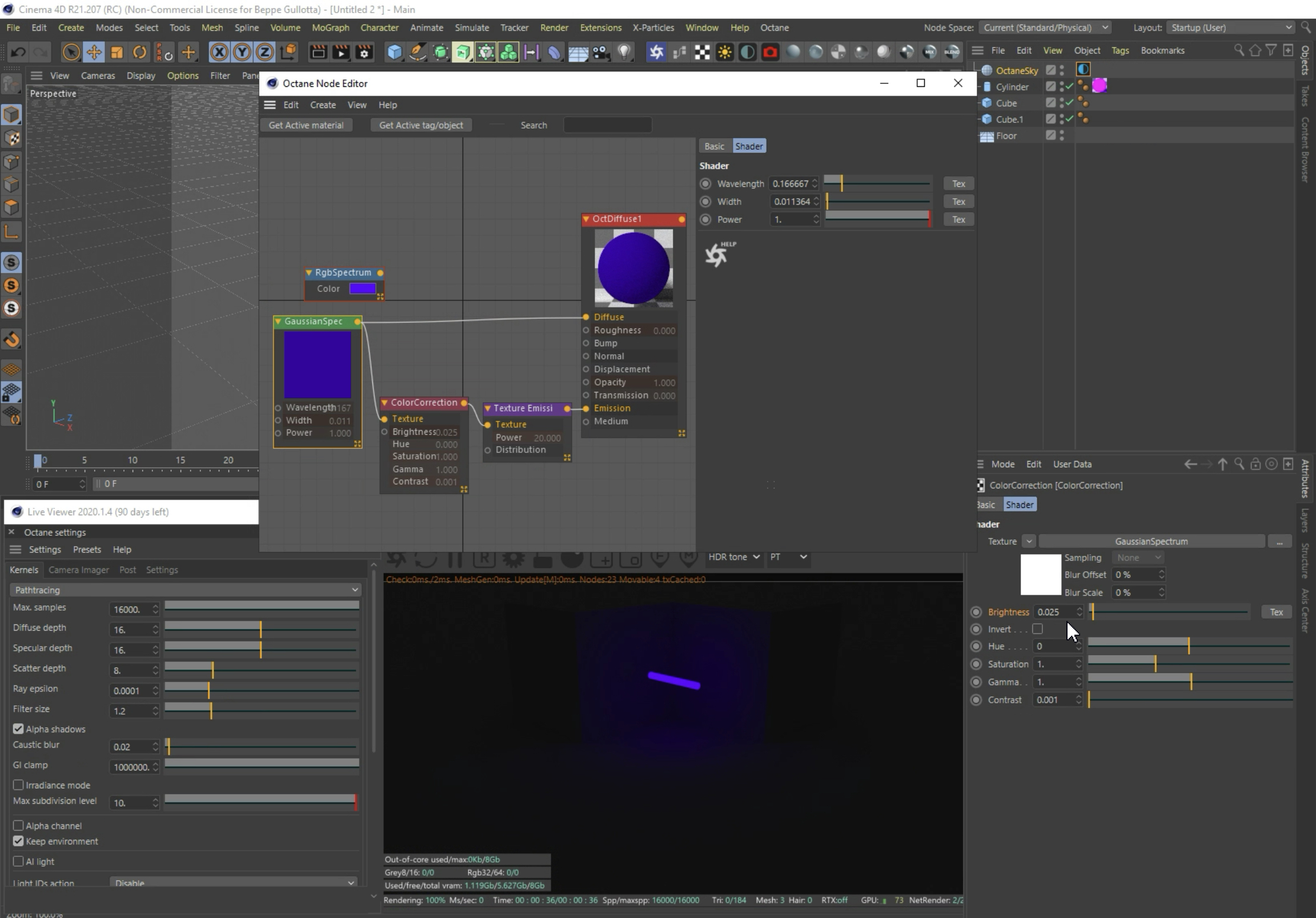

please post a screenshot of the material nodes setup.
Here is a version in c4doctane with Gaussian Spectrum node:
ciao Beppe
