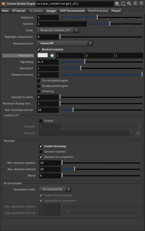

Hi, I'm wondering if anyone else has noticed this issue and or if someone can point me to what I could possibly be doing wrong.
If I export a render from Octane Standalone or any of the plugins as ACES the resulting image once imported into an image editing app like Affinity Photo, Photoshop or even Davinci Resolve shows a considerable red tone. For the attached render I'm using Houdini's MPlay to be able to use it's ACES view transform (I'm using ACES 1.2, however this issue is consistent with the earlier releases as well). In Affinity and other tools I'm converting from ACES 2065 > Scene linear. I get a slight bit less of the red tint when converting from ACEScg to SL, but then it doesn't match the color saturation seen in the IPR and is still tinted. I realize that it's still early days for ACES in Octane, but I thought I'd bring it up in case there's an issue with the implementation.
Thanks in advance,
Travis

Imager settings
Imager settings

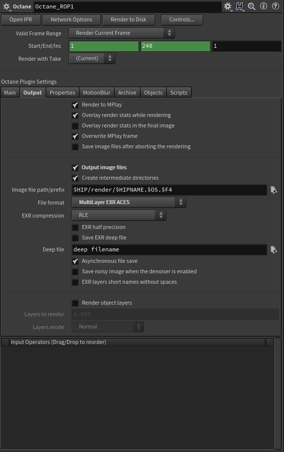

ROP settings
ROP settings
