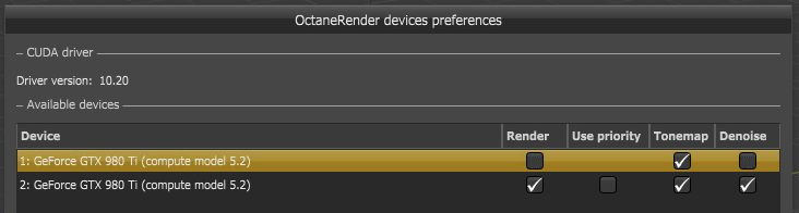

I just purchased the studio subscription, but I can not use the 2 GPUs. When I select the second GPU it will show a cross for some milliseconds, but not a checkmark.
What is the problem?

I first used the free version of Octane. After purchasing I hoped I the free version will be unlocked for 2 GPUs.
Then I downloaded and installed the 2020.1 - 21.7 Blender for OctaneRender Installer. But it is the same.

Hmm I had also download another Octane Server. Now I can use 2 GPUs.
This is big crap! :-(
