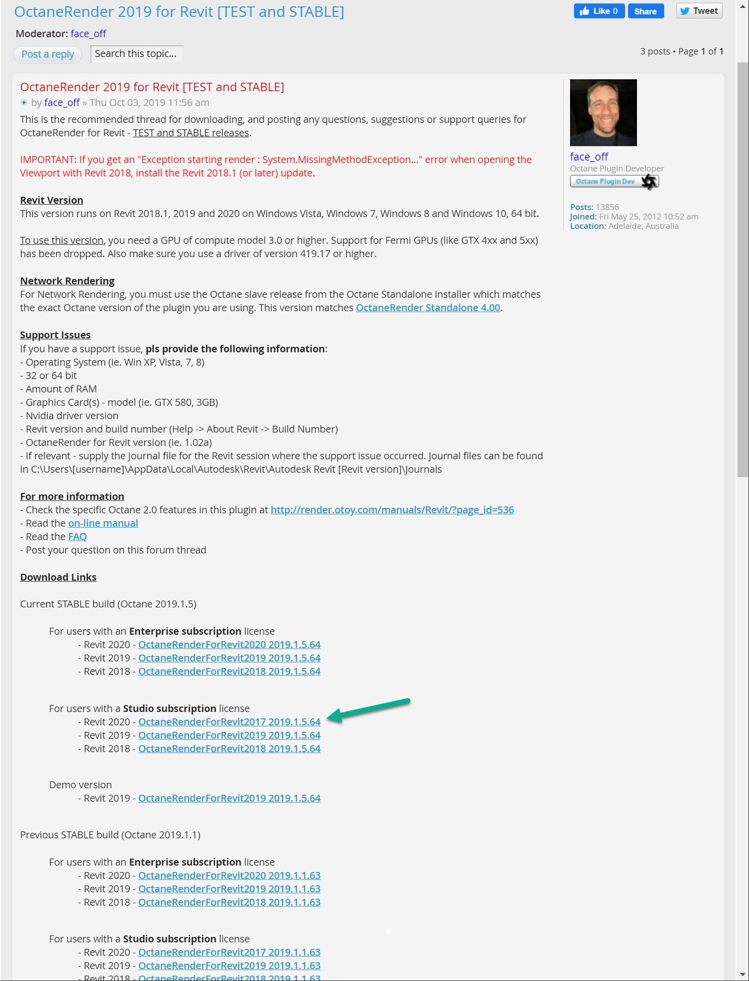

Hi Faceoff,
Thanks for getting back to me. I have the studio license with 2 gpu limit. Please see attached screen captures. First shows the page I downloaded it from (green arrow). Second shows the downloaded files on my computer. I can download a earlier release if you want. My only requirement is it should install on Revit 2020 without admin rights and export to standalone.
