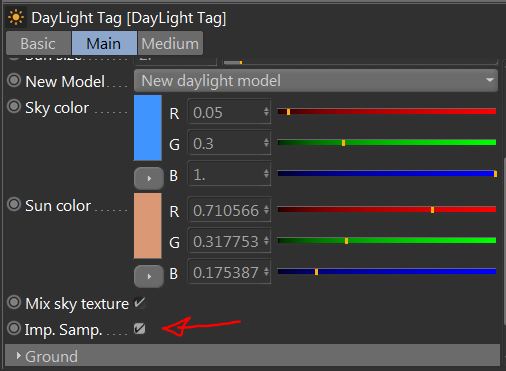

4/ In the sun settings, I enable the “imp sample”, as recommended in octane's manual, for the shadow ( although i'm not sure how to use the shadow pass ) :
Shadow Pass - This pass contains all direct light shadows calculated on the first path bounce. The pass includes sun light provided by the Daylight environment node. The Shadow pass excludes the Sky light (a.k.a Octane Sun+Sky environment) or Texture environment if the texture environment does not consist of an image. If the Environment node contains a Sky light or Texture environment that is contributed by an image texture, the pass takes the Environment node's Importance Sampling value into account. Make sure to enable Importance Sampling in the Environment node to include the Sky light or Texture environment in the Shadow pass.
Figure 4: A scene with an Octane Sun+Sky environment is rendered with a Shadow pass twice for comparison. The resulting passes with Importance sampling enable and disabled are compared
