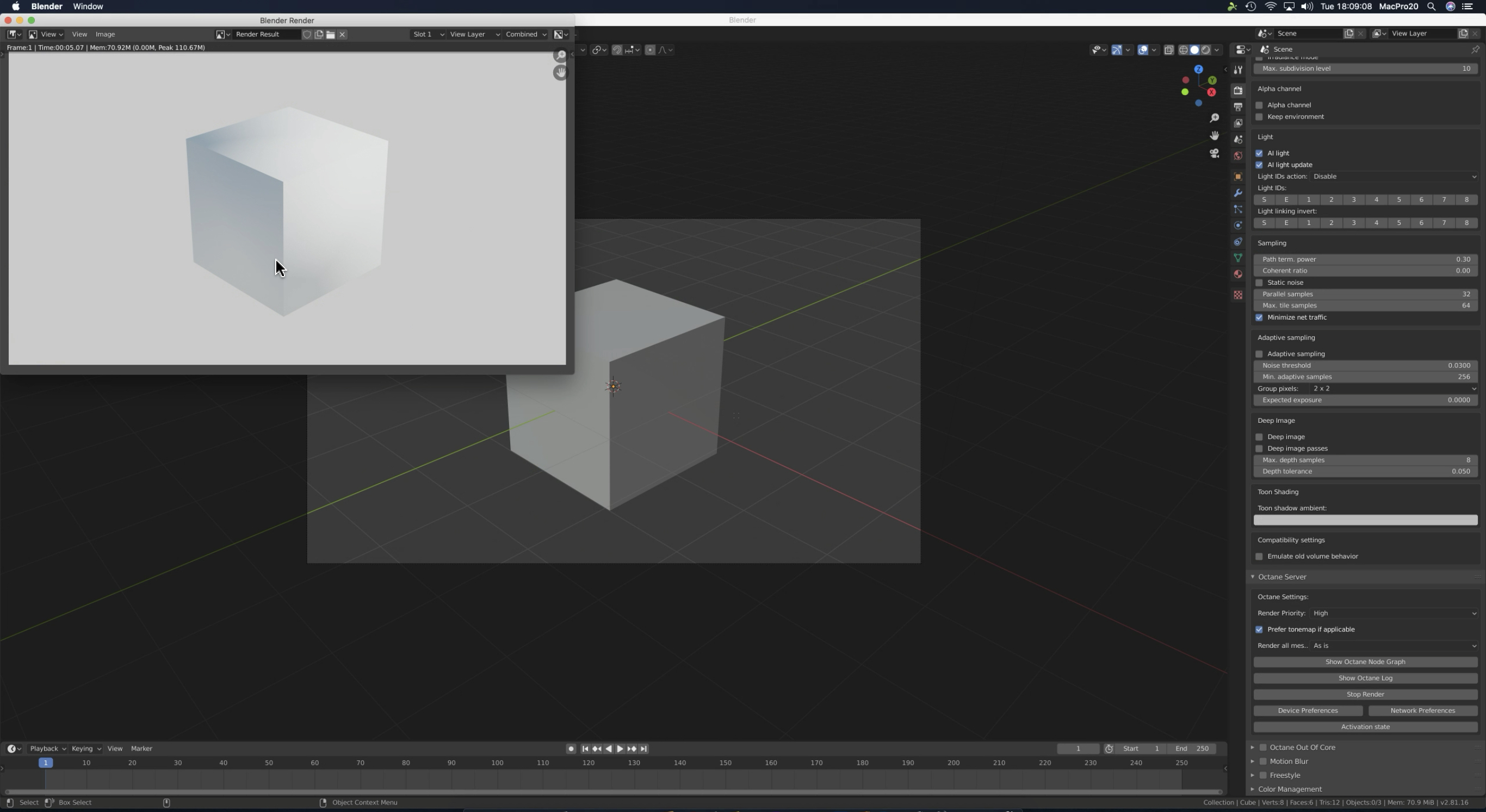

at the moment you can’t out of the box.
You need another PC equipped with Nvidia GPUs:
viewtopic.php?f=24&t=45208#p242913
Blender Octane 2020 on Catalina, with RTX GPUs on PC
or you need to go back to High Sierra, and use an eGPU box via Thunderbolt 3, I personally work everyday with an iMac 27" 5k 2017 with Thunderbolt 3 eGPU 2x 1070, under High Sierra.
Note that it is necessary to install a custom script, and some precautions, so let me know if you are interested in this solution.
Please, also note that we are going to introduce Octane X, in next months, to definitely solve all this kind of issues switching from Nvidia CUDA to Apple Metal under OsX:
https://home.otoy.com/octanerender-year ... tane-2020/
and here for more details:
https://www.facebook.com/groups/OctaneR ... 203888553/
When ready, we will be able to render directly with AMD GPUs in Catalina natively, without custom solutions.
ciao Beppe

you still need High Sierra 10.13.6 + CUDA 410.130 + Nvidia GPU to be able to use Octane on Mac.
