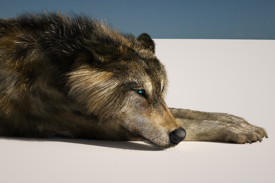

If you have LAMH based fiber hairs then can render it easily. Here are 2 examples of the custom materials I am using on the wolf's fur.
Wolf 1 LAMH
Wolf 1 LAMH
Wolf 2 LAMH
Wolf 2 LAMH
For Daz strand based hair you can do Preview PR Hairs and set the Viewport Line Tessellation Sides to something like 3 to see the hairs in Octane and then add materials to it to show properly in the render. I guess the issue will be how dense the preview will be. Not sure if it shows 100% of the strands in the Daz Viewport that IRAY render will show.

All rendered with PT Kernel, HDRI environment, 1000 samples. Each render is 900x600 and took around 6 to 9 seconds to render. The LAHM wolf has around a million hair strands. Not sure about the Husky.
The wolf and husky both are using the image map that came with them plus the custom material. But I think the texture applies to the full hair. No difference between the root and tip. I guess it can be done but probably need to do some RnD. Wolf has full custom materials. Husky, I just did a quick edit. Have not tweaked the materials yet to make them look better.
