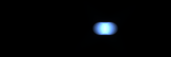

That is not what I am seeing, depending on the "Shutter alignment" setting in the "MB" tab of the Render Target node. Only a "Shutter alignment" setting of "After" yields the expected result:
0% motion blur; Shutter alignment: Before
0% motion blur; Shutter alignment: Symmetric
0% motion blur; Shutter alignment: After

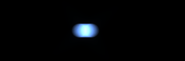

Also, no matter which "Shutter alignment" setting I choose, when motion blur is turned on I cannot get the blur to trail the object that is being blurred (think of a comet with a tail--that's the look I'm aiming for). OctaneRender seems to be ignoring the "Shutter Open" and "Shutter Efficiency" settings in LightWave; no matter what these are set at, the blur always seems to be in front of the moving object, which is completely wrong--the blur should be after the object. Making the "Shutter alignment" "Before", "Symmetric", or "After" only seems to be moving the position of the overall blurred object; it has no effect on where the blur is occurring on the object itself:
25% motion blur; Shutter alignment: Before
25% motion blur; Shutter alignment: Symmetric
25% motion blur; Shutter alignment: After
If I superimpose the non-blurred versions of the blue ball on top of the 25% blurred versions it's easier to visualize what I'm talking about. In all three cases, the non-blurred ball (which, remember, is moving right-to-left) is trailing the 25% blurred ball; the only thing that changes in each case is that the "Before" and "Symmetric" shutter angles visually put the object at the wrong location; only the "After" shutter angle positions the ball where it should be (0,0,0). And again, no matter what combination of settings I use, I cannot get the blur to trail the non-blurred part of the object; the blur is always preceding the non-blurred part of the object. It's as if the tail of the comet is in front of the comet!

As I understand motion blur and film exposure, Octane is behaving correctly. The film doesn't know which direction an object is moving, it only knows the interval any given point has been exposed to light.
Say you have a sphere with a diameter of 10 units. It moves at a constant speed to the right. In the time the shutter is open, it moves ten units. Both the left and right edges of the sphere image have been exposed for the same amount of time. The blur should be uniform, left to right, across the entire object. It doesn't matter when the shutter opens, whether it's the beginning of the frame, the middle of the frame, or the end of the frame. Regardless of exactly when the shutter actually opens, relative to when you think of your frame, the shutter is open for the same amount of time, and the exposure will be uniform across that period of time. What changes is the position of the objects in that rendered frame, not the position of their blur.
The "Shutter Alignment" setting adjusts the timing of the shutter mechanism, relative to the time you choose to label your frame, that's all. It doesn't change the actual exposure.
In other words, if you take a picture of a real golf ball flying through the air, it will be blurred along both the positive and negative motion vectors, just as you are seeing. The following image is exactly what I would expect, and is accurate to how it works in the real world.

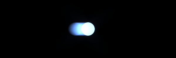

Something does seem broken in the Octane implementation of shutter alignment. Shutter alignment set to before yields no blur at all. Shutter alignment should be the same as front or back curtain flash sync in cameras. Which is to control whether the flash is fired at the beginning of the exposure, or the end. Objects rendered with no motion blur should be sampled at the time in the frame based on the shutter alignment. In other words, with no motion blur, it should represent where the instantaneous image is grabbed in the duration of time represented by the animation. 1/24th of a second, 1/30th, etc.
I'm trying to get the same effect as the original poster. I have two animated, moving lights at the same position. One has motion blur, the other does not. If I set the shutter alignment to after, I get a motion trail in front(in the direction it's going) of the brighter light with no blur. If I set it to before, there's no blur at all. Symmetrical yields the same exact result as after.
The comet effect described above is possible with a real camera and a flash using front or rear curtain sync. The representation of the object frozen in space by the near instantaneous flash would either precede or follow the blurred representation of the object in motion. It should be possible to render the same thing if Octane had implemented the shutter alignment correctly. Even the naming, before and after, suggests the original author perhaps didn't understand the feature they were trying to implement. It should be labeled start and end rather than before or after.
