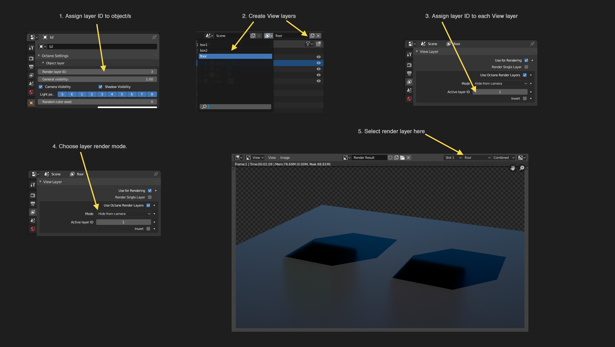

To make it work there are few steps to take:
  • 1. Assign layer IDs to object/s you want to be on separate layers.
    2. Create View layers you want to render.
    3. Assign layer ID to each View layer.
    4. Choose layer render mode. More on render modes are here – https://docs.otoy.com/StandaloneH_STA/S ... Passes.htm
    5. Press render and after it finishes select render layer from dropdown menu located on the top left corner in render window.
Sample blend file:

Thanks much for that clear outline of steps J.C. Very useful. I haven't tried Octane Render layers in 2.8 yet so this will come in handy.
