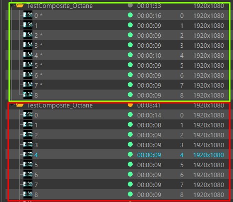

I'm on latest version of Octane 4(Not 2018) a gigabit Ethernet and when I do the test to compare I get pretty much same result...If not sometimes longer when adding slave...Would I notice a different in longer renders you think?
I've attached a screenshot of a test, highlighted in green is the network render with all GPUs binded....Highlighted in red is the master only...
Just seems odd that I've getting literally no speed increase at all after investing in another machine :/

please, try to decrease the Max Tile sampling at 8, or lower, in the Kernel settings, and report back, thanks.
ciao Beppe

Also, frames that only take a few seconds to render on one machine may not see much improvement with network rendering. Depending on the scene, plan on at least a few seconds of network overhead and coordination for every frame. Try rendering frames that take a minute or two each, and you should see a big difference.
If you have lots of individually fast (less than 15 seconds each, for example) frames to render, it may be significantly more efficient to split the job into two parallel tasks on two machines instead of trying to shoehorn them all through a single, networked render queue.
