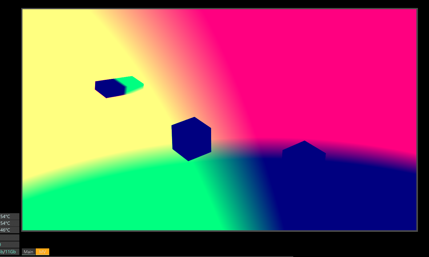

i have a problem whit Motion vector pass.in live viewer show motion vector but in picture viewer show gray map!!
motion blur in render : Disabled
motion blur in camera : enabled 0.01
tonemapped type
octane render v 4.04.R2
c4d R20 but tested on R18 & R19
win 10
motion vector pass in live viewer
file sample
https://we.tl/t-7AO1cVlkb1

It looks like an usage error. You disabled motion data from this parameter

aoktar wrote:It looks like an usage error. You disabled motion data from this parameter
Thanks aoktar
I read on the forum that you said it should be disabled.
At the bottom of the live viewer is also written.

I don't know where is that! Could you point me?

It doesn't mean that disable it. Just informs you you'll not see blur effect in renders because you have mblur pass.
