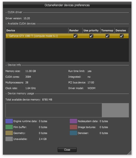

sigh - tried to get Octan plugin working for a new project. Open viewport failed (I think old plugin was 3.8ish). loaded latest version which said it was 4.04 but reports on activation screen as 4.00.0.101. Still nothing works. When I try to load the viewport I get:
OctaneRender 4.00 (4000021)
Started logging on 23.05.19 19:11:31
CUDA error 999 on device 0: unknown error
-> failed to link file
device 0: failed to load OSL shader code:
error : Multiple definition of 'cuSptStatistics' in 'cuda_texturenode', first defined in 'snippets_internal'
device 0: failed to compile module 0
Device status seems OK. Renderer set to octane etc. Really no change from past.
OTOY device status
OTOY device status
Even materials do not render...
Material with octane as renderer
But the same material when I switch to a native renderer at least is not borked.
Material with Rhino as renderer
Nvidia 1080ti with driver 430.64 - just updated earlier this week as it happens.
Seems to be some very fundamental driver issue. Have no idea where to go with this. Advice VERY MUCH APPRECIATED

Update to the latest version of the plugin please.
Paul

Well how stupid was I! (Face Palm) I was checking in wrong places for the plugin. Doh.
Thank you for your patience
