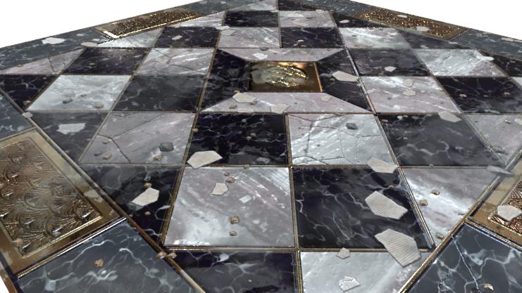

I downloaded this sbsar file from the SubstanceShare website and added it to a ground plane in modo:
Abandoned_Hotel_Marble_Floor.7z
(146.83 KiB) Downloaded 287 times
Modo's render looks correct:
The octane render looks ok until the normal and basecolour outputs are added. I've added the outputs one at a time:
AO
AO + Height
AO + Height + Spec / Metal
AO + Height + Spec / Metal + Rough
AO + Height + Spec / Metal + Rough + Normal
AO + Height + Spec / Metal + Rough + Normal + Basecolour
The Normal and Basecolour outputs aren't mapping correctly. I've had the same issue with most of the materials from SubstanceShare, although a couple look fine.
Seems some others are having the same issue here, which was last updated 18th December 2018:
https://forum.allegorithmic.com/index.php?topic=6125.45
I suppose this could also be an issue with the SubstanceInModo plugin, I'll reply to the allegorathimic forum to see if there's been any news.
Cheers,
Dino.

Hi Dino
I am using Substance 2.4 and could not reproduce these issues, so I suspect there might be an issue with the 2.7 version of Substance.
Paul

Hi - I have now tested this on Substance 2.7, and yes, the normal map appears to be not working, and I have had the diffuse map working sometimes, not others. I have reported this to the Substance devs.
Paul
