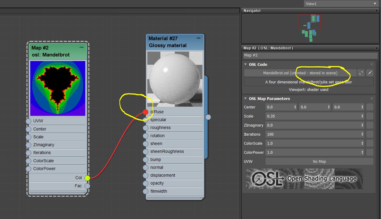

Do I miss something or is there a "in between node" already?
This should not be hard, but very convenient.
benefits
-no separate osl files (if unlinked)
-max internal script editor
tnx
boris

tnx Paride but I am not sure you understand:
I know can use Octane OSL Texture with a file.
But take a look at the functionality of the 3dsmax Node. It's good because you can edit the osl if you want and then it will be stored in the Max file.
Would be nice to be able to connect that (similar like the developpers made the link to the 3dsmax image map texture).
This can't be hard.
It's a feature new in 3ds max 2019 .
cheers
boris

Hi Boris,
mouse rightclick on .osl in Octane OSL slot.
Regards
Paride
