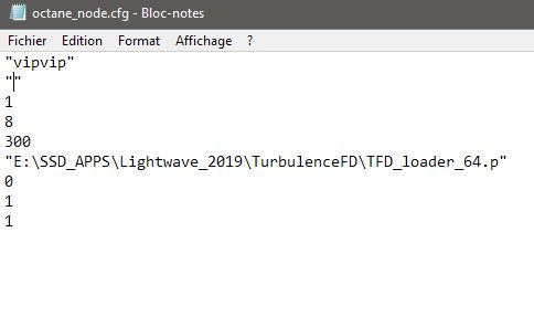

Re: LW 2019 + Octane 4.02 : NRC render doesn't start
Posted: Wed Feb 06, 2019 9:20 am
by vipvip
thanks, i followed all the infos but it still doesn't start... attached, the screen grabs...
I'll try a post on newtek forum...
