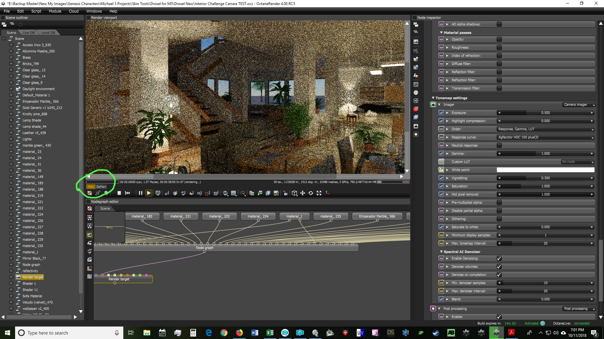

Thanks so much for this plug-in. So far so good on my end the only question I have is about the denoised view. After enabling denoising in the Render Target i do not see any option to view the Main vs Denoised versions of the render. Can you possibly point me in the right direction? Thanks, Sighman.

You need to use render passes to see the separate channels. Under render passes there is a denoiser tab with a number of options. After enabling the passes you want you can switch between them using the drop down on the render view window.rashadcarter wrote:Sighman,

Thanks. Yes I had seen this and enabled it previously. However in the standalone version there is an option for denoised beauty. That is what I am seeking at this momentSighman wrote:You need to use render passes to see the separate channels. Under render passes there is a denoiser tab with a number of options. After enabling the passes you want you can switch between them using the drop down on the render view window.rashadcarter wrote:Sighman,

Apologies if my terminological usage is incorrect. What the standalone offers is a Denoised Main view. I have attached a screen shot of the standalone. This is different from the separate individual passes, at least i think they are different but please inform me if I am wrong. Thanks as always, Sighman!
