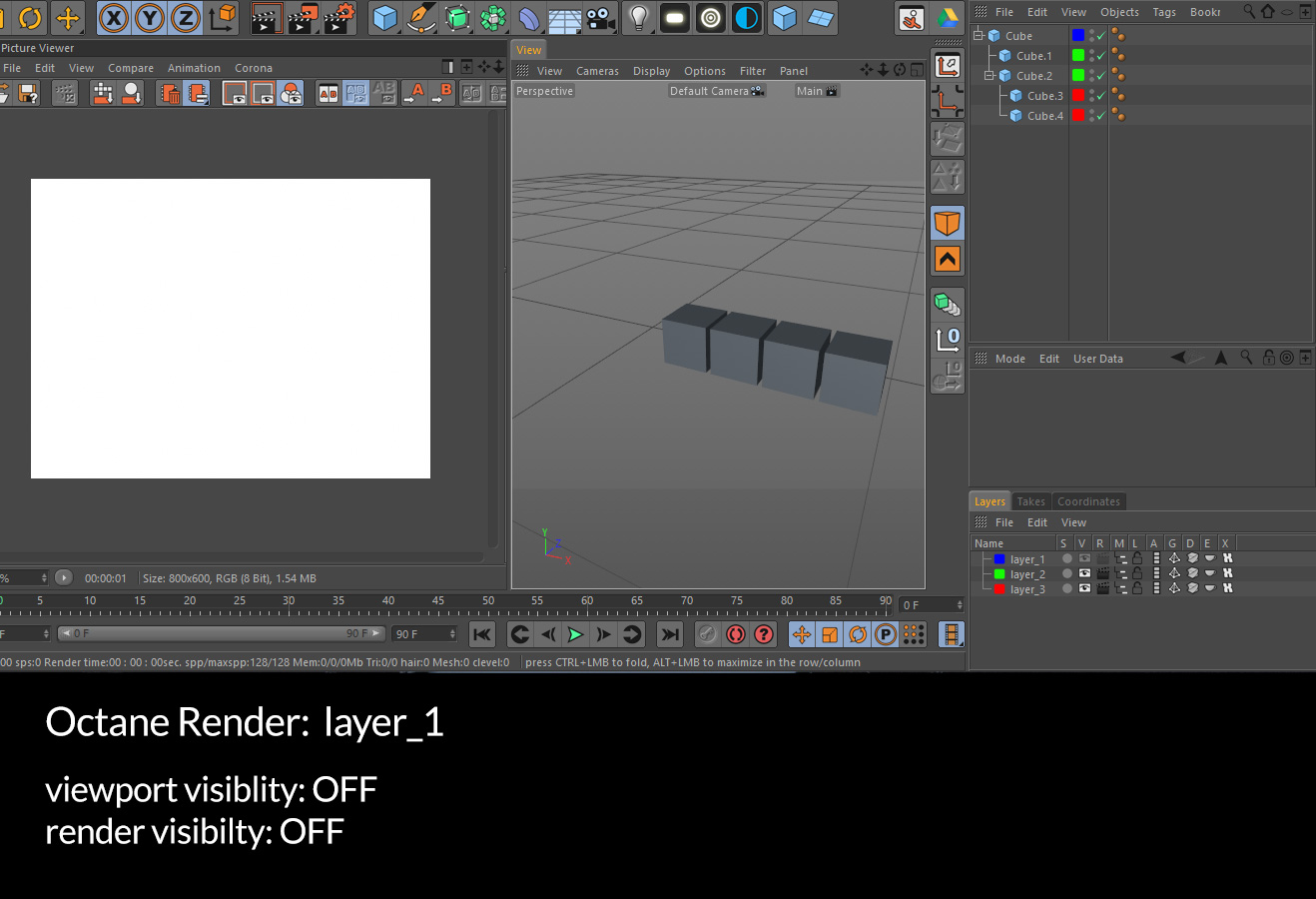

Hi Aoktar!
I have noticed problem when using Layers in C4D.
If I assign multiple layers hierarchy of multiple objects (like in screenshot above)
and I turn off render visibilty to layers that are in above of other layers in hierarchy, the most top layer overrides
all the layer settings that are above it in the hierarchy.
This only happens with Octane.
With Cinam4D built in renders , it works as expected.
I could use those those two little dots in Object manager, but its not effective when we have to deal with big hierarchys of objects and
its un-effective to browse throught everything and manage things.

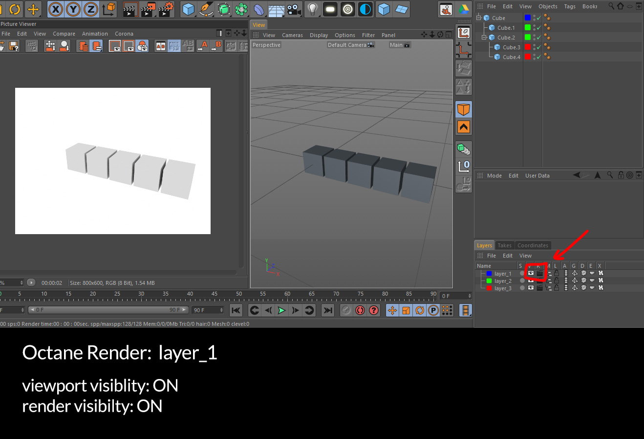

Here is example (used scene attached)
1) layer_1
OCTANE RENDER
viewport visibilty: ON
render visibilty: ON
2) layer_1
OCTANE RENDER
viewport visibilty: OFF
render visibilty: OFF
In this scenario, the most top layer is overriding every layer that is below, but it shouldnt work like this.

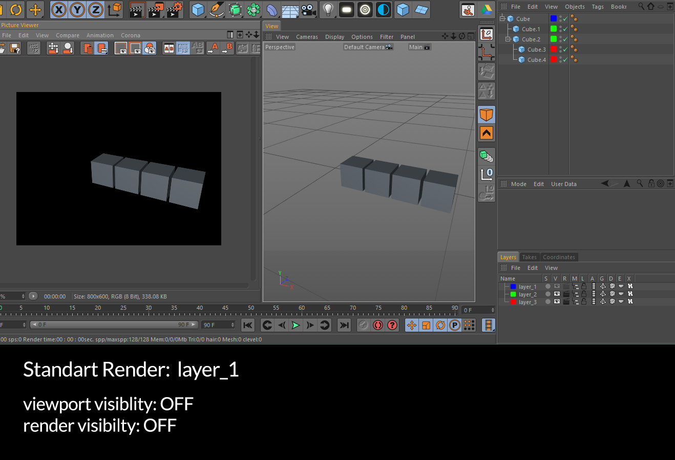

3 ) layer_1
STANDART RENDER
In this scenario, where Standart render is used, everything works as expected, layer_2 and layer_3 is overriding layer_1 and they are rendered the way I had chosen in Layers manager.

Re: Layer hierarchy overriding not working
Posted: Tue Sep 04, 2018 11:30 am
by aoktar
Could you please attach images in your post? I couldn't see otherwise.
Posted: Tue Sep 04, 2018 12:24 pm
by tomsvfx
I updated image in this topis and also in my other topic I created today viewtopic.php?f=86&t=68693&p=345222#p345222
