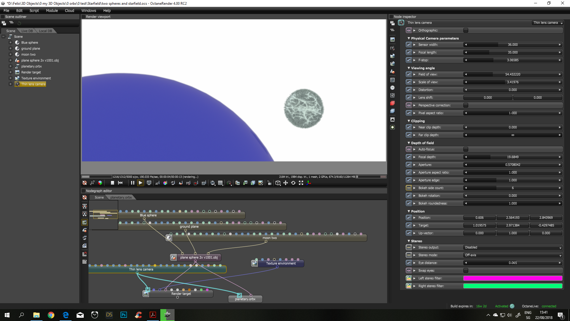

To better understand the scale I created a simple scene with two spheres and a ground plane.
sample scene - two spheres with ground plane
I attached the .obj in a .zip file:
plane sphere 2x v1001.zip
zip file with .obj of one plane with two spheres
(62.32 KiB) Downloaded 390 times
With the help of the two spheres as reference point for me it was easier to understand what changing the planetary environment settings does.
Hiding the ground plane yields a more artistic effect but then it is once again more difficult to understand that the planet is actually "below" or "behind" the ground plane.
Planetary environment behind ground plane

I think your experiments with the additional spheres explain what I mean better than what I was trying to do with words. Yes, exactly, the planet will always be behind/below every other "real" object, because the planet is not really an object at all, it's part of the shader created environment.
For some shots it would be interesting to have the planetary environment in just one corner of the image.
Basically what seems missing (or is not possible based on what Frank described) is a way to "offset" the planetary environment from its origin point.
Or is there another simple setting I am overlooking?
From what I've seen, you can shift the planet surface off the image vertical center line using just the Environment node's camera, although it introduces other distortions.
The first image is a schematic of what's really going on, which is that the planet is actually part of the environmental projection map. The second image shows a render where the planet is offset from the center line using just the Environmental camera, and you can see that the Milky Way is badly twisted when it should be straight. If you use a second camera, as in the second image, you can offset the planet from the centerline without adding noticeable distortion.
With the right combination of Environmental camera Altitude and the second render camera's orientation and FOV, you should be able to frame the planet pretty much any way you want.
Edit: I'm not certain you can't get the same offset without distorted results with just the Environmental Node's own camera (pardon the double negative), but it seems a lot easier using a second camera. I don't think this environment node is really designed for what we are trying to make it to do (distant space shots, as opposed to high altitude or low orbit), but it's interesting to push it.
