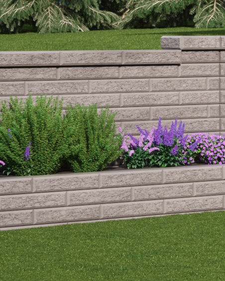

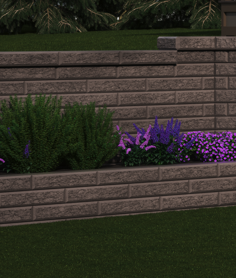

I'm getting this:
When I should be getting this:
Can anyone help me? I don't want to throw more money at this if it will not render correctly. The octane version I'm using is 3.06.4 on both my side and on ORC.

Hi Draydin,
open your .orbx in Standalone, and check the response curve/gamma settings compared with the output format you have chosen.
If the saved rendering is correct in Standalone, you have to have the same result also in ORC.
