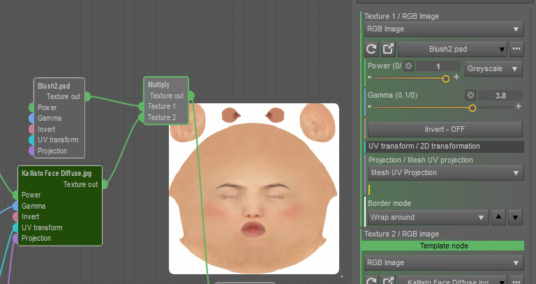

I don't know how it's with that character, but Kallisto has a separate blush texture. You can save the PNG as PSD (PNG won't work for some reason) and add it via multiply to the basic face texture. You can adjust the strength with gamma.
Maybe Raquel has separate makeup textures (which would actually be quite cool...)

We've already tried to incorporate this into RedSpec.
Only problem is, that the channel, which contains the make-up overlay is currently not targetable with the templating system.
Same problem with outoftouch's hair overlays.
As soon as this happens, we could implement it. This is a problem on the plug-in development side of things, though.
As you've already found out, the current solution is to manually insert the make-up overlay via a Multiply, or better, a Mix Material node.
