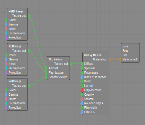

All the gen 8 Daz characters do this with their make up so far (V8, O8, etc.), the image with the make up is a PNG with a alpha channel, so you can use the RGBA image node to get the alpha to use as a mask for a Mix Texture node. I've attached examples of how to set it up in the NGE.
Node layout example.
Node layout with textures applied.
As an added bonus, you can mix and match the make up textures you put in the RGBA node and the RGB node, not all combinations work, but a lot of the time an alpha channel of one make up image will work with the colour channels of another make up image, just try them out and you can get a few extra styles.
For me this works much better than an Add Texture node, as it doesn't mix the 2 images together in a uniform way. There's probably a better way of doing it, but it's the best way I've worked out so far that works.
In theory this method can be used instead of the L.I.E. and you can even layer it up to a certain extent, so I generally do this now rather than using L.I.E., as it's faster and you don't have the problem of using L.I.E. temp files and them changing when you reload a scene (I'm sure there's some more complicated uses of the L.I.E. where this wont work or would just be to much of a pain to set up).

Hi there .. trying to figure out how to use the LIE stuff with Octane and I saw this thread but there's lacking an explanation for what texture nodes are for what.
In the diagram .. you have an alpha channel for the makeup. I guess if you have the makeup (or tattoo or whatever you're layering) in alpha then this goes here.
But the next two are what exactly?
One will clearly be the face texture .. and the other ??? .. makeup texture again? Why would you need that if you have the alpha channel to overlay.
I know the alpha is set to amount (although I don't really comprehend what this is doing because this is magnitudes of processes beyond what my brain can handle .. but I guess it's controlling how much of one texture there is? . .. How exactly .. and which one is it controlling?
I want to layer bruises and tattoos .. and so far I hadn't found any way to incorporate the LIE stuff .. I had just figured it wasn't possible with Octane .. but then I saw this and it seems it is. A bit convoluted in how it happens (like .. what happens if my tattoo is underneathe the skin layer? .. Which one sits on top of which .. it's not very clear.
Anyways .. if someone could explain the diagram a bit more thoroughly I'd be much obliged as this clearly is a useful topic .. but lacks coherence for users like myself who are still fairly new to the node editing thing.
