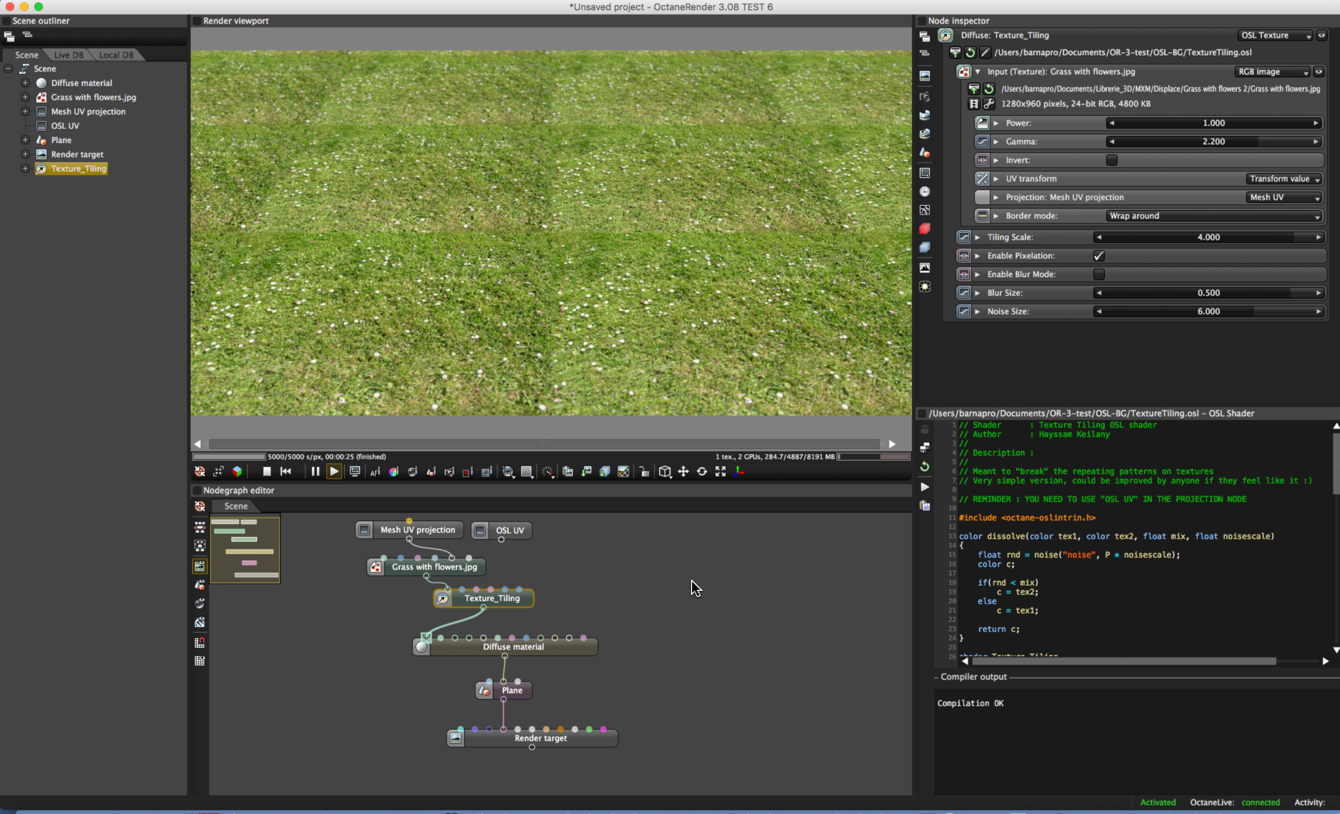

Hi franchais,
you need 3.08test 6, to try out OSL nodes.
before
before
after
after
texturetiling.orbx.zip
(2.5 MiB) Downloaded 461 times
ciao beppe

Thanks Bepe, that worked. Just one thing, where did you gett the osl editor on the bottom right of your image?
Re: Creating seamless material
Posted: Tue Jan 09, 2018 8:31 am
by bepeg4d
Hi franchais,
you need to enable the Script development option in Preferences/Application:
ciao beppe
