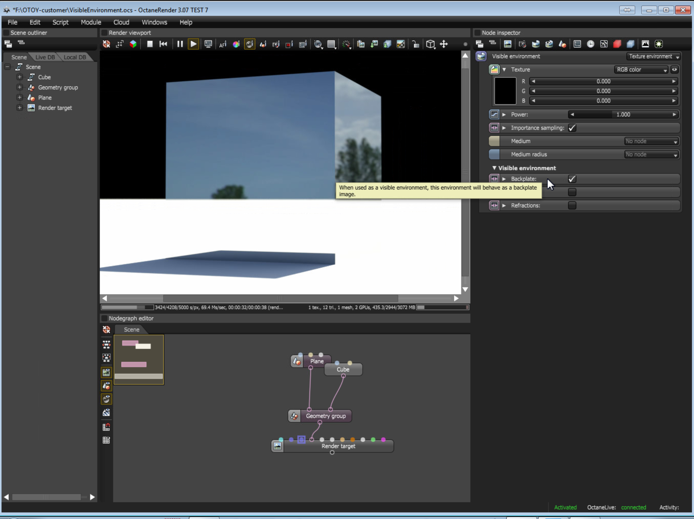

Hi Sergestra,
another solution in both Standalone and plugins, is to use a Visible Environment node with Gray or RGB color node in black mode, and the Backplate option active:
In this way, the primary Environment light will not be changed, and you have not to deal with Alpha channel.
ciao beppe
