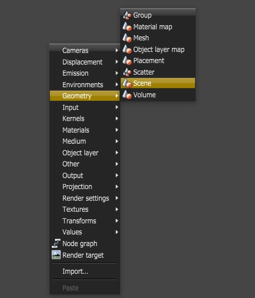

In OctaneRender Standalone, blur effects are applied through the Animation Settings Node and there needs to be animated geometry provided by an alembic geometry scene node.

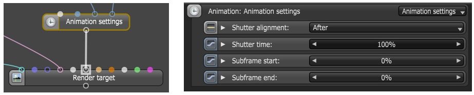

Shutter Alignment (Trigger)
The shutter alignment specifies how the shutter interval is aligned to the current time.
This determines when the camera shutter is triggered. This can be before, symmetrical or after, and applicable to each frame thereafter relative to the given frame rate.
Shutter Time
This specifies the shutter time percentage relative to the duration of a single frame. Shutter Time controls how much time the shutter stays open, this can be set to any value above 100% manually.
Subframe start and Subframe end (Subframe interval)
Specifies the approach, in terms of proportion (%) to simulate the camera’s shutter speed for that particular frame. Subframe start and end percentages are used to only render a portion of a particular frame. So if the scene has a lot of motion blur, users can choose to render only a piece of that motion blur, and then shift the start and end times. That way users need not rebuild the geometry at all. 0% to 100% is the whole frame (Default).
These two pins, subframe start and subframe end, allow users to reduce the rendered shutter interval to a sub-interval. This is useful if there is a need to double or triple the frame rate without having to re-compile the scene 2 or 3 times more often. In the Standalone, this can be done very easily by increasing the subframes value in the batch render script.
For example, Given that Shutter Time = 100%, the shutter is open during the entire frame:
