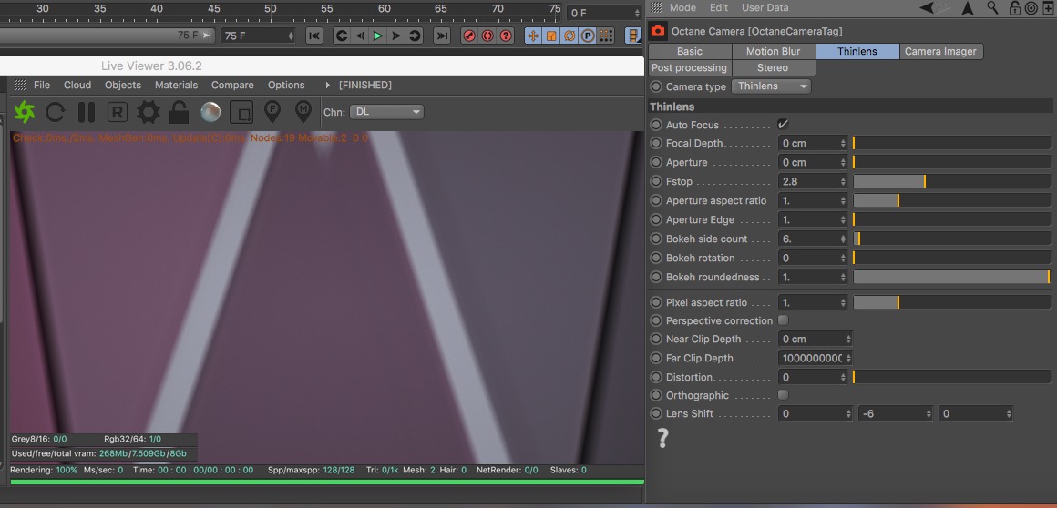

And the Lens shift value in the Octane Camera node works in meters, so you need to enter -6 in the Y axe:

Hi volkmar, I just wen through this same issue on a project myself. The solution is to "lock" the live viewer and then adjust the resolution multiplier if needed. If the Live Viewer is not locked, then you get a multiplied/incorrect shift.

dearthman wrote:Hi volkmar, I just wen through this same issue on a project myself. The solution is to "lock" the live viewer and then adjust the resolution multiplier if needed. If the Live Viewer is not locked, then you get a multiplied/incorrect shift.
It's correct.
