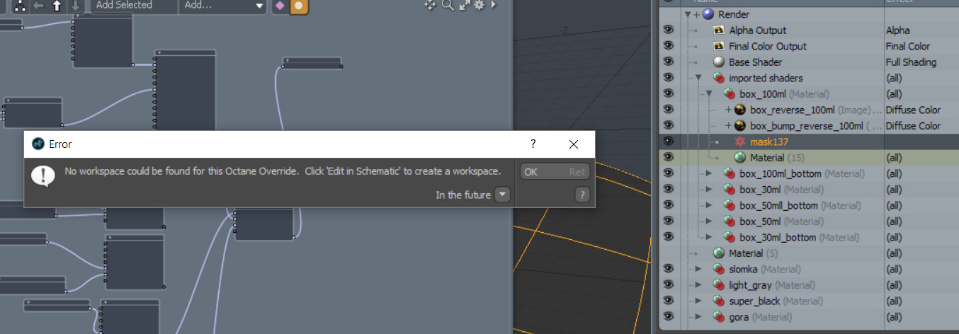

so I've just opened up an older file (like from 1 year ago).
And I'm missing all of my Octane overrides. I mean they are there in the material group but the moment I open them up in the schematic I get this:
Any ideas?
I'm a bit worried 'cause these materials were tweaked A LOT and now I'm missing all of it :cry:

Situation 1)
There is another specific situation in which the error is occurring. When I import a model, of which the material includes an Octane Override,
from one scene to another in Modo. I'll elaborate:
I import the model from scene_01 into scene_02. In scene_02 Modo automatically creates a group called 'imported shaders' in the shader tree
(which it logically always does). Now when I go into the group and find the Octane Override material the name is changed into maskxxx.
When selecting this Octane Override I get the error:
"No workspace could be found for this Octane Override. Click 'Edit in Schematic' to create a workspace."
Then clicking on 'Edit in Schematic' in the Octane Override gives a 'Failed' pop-up. Also when having pressed 'Edit in Schematic' it
creates an empty assembly group/workspace called maskxxx in the Groups overview underneath the Groups tab.
But, changing the name 'maskxxx' into something new (like for instance 'plastic'), suddenly the Octane Override schematic opens up and is editable again.
Also it also creates a new assembly group/workspace by that name 'plastic' in the Groups overview which now has the items included that are in
the Octane Override schematic.
Now when I export this to an .OCS to see if the shader still picks up of all of its attributes in the Octane Standalone it seems to work just fine.
So essentially renaming the Octane Overrides solves the problem that, when one is importing a model which has an Octane Overrides into another scene,
makes the Octane Override not editable anymore.

The renaming of the Octane Overrides occurs when you Import an .lxo, rather than Load it. This is controlled by Modo - so there is not a lot the plugin can do about it. When you Import, you need to click "Edit in Schematic" so the plugin then renames the node (as you have worked out).
