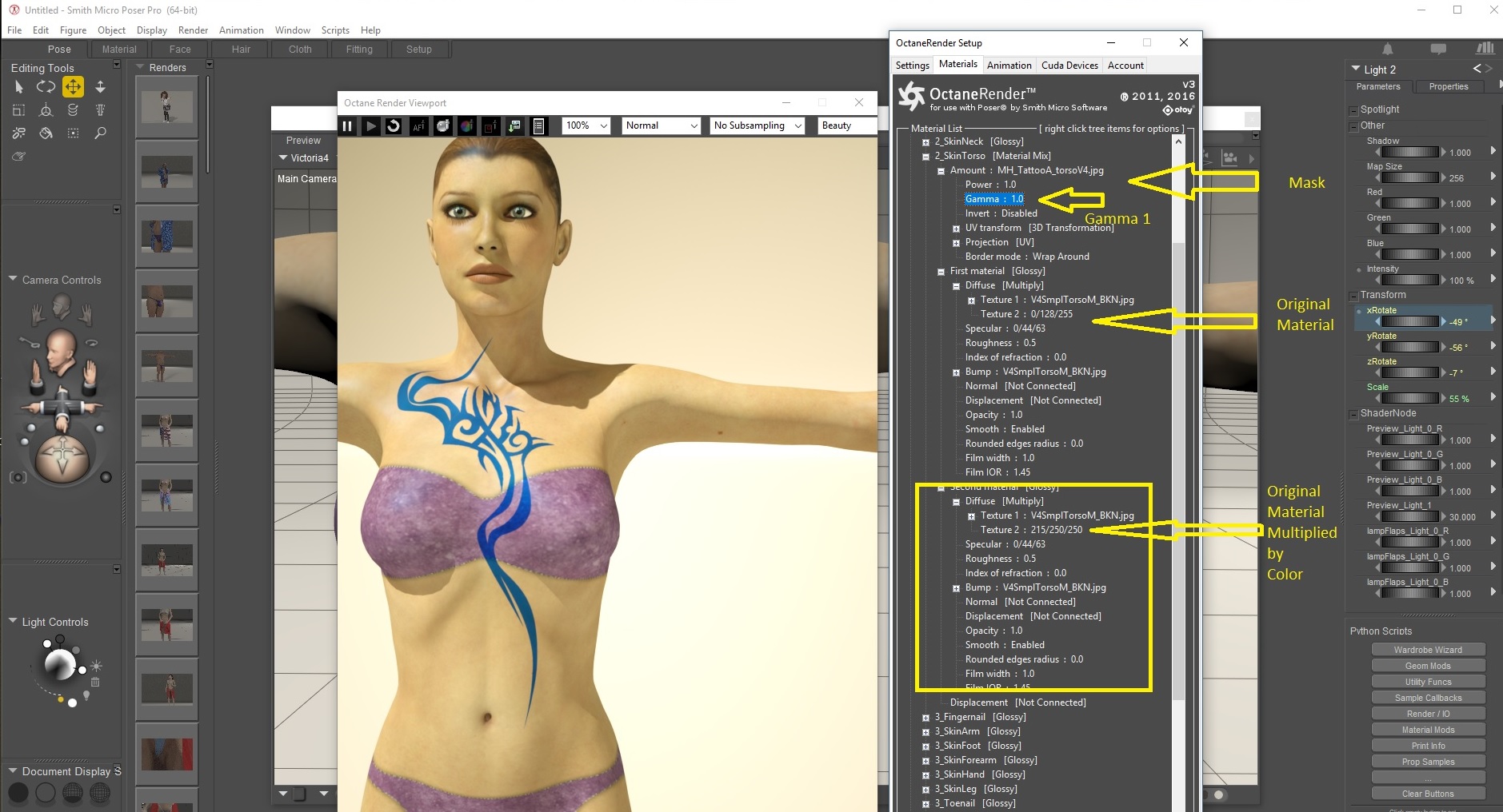

Example - for a tattoo:
For an emittor, use the mix in the same way: Use the mix in the texture color, mask in the value, color 1 in texture1 and color 2 in texture 2

Aha! I didn't realize the amount could be an image too! Nice! I get the tattoo, thanks.
And the glow is working VERY nicely too! Many thanks!
