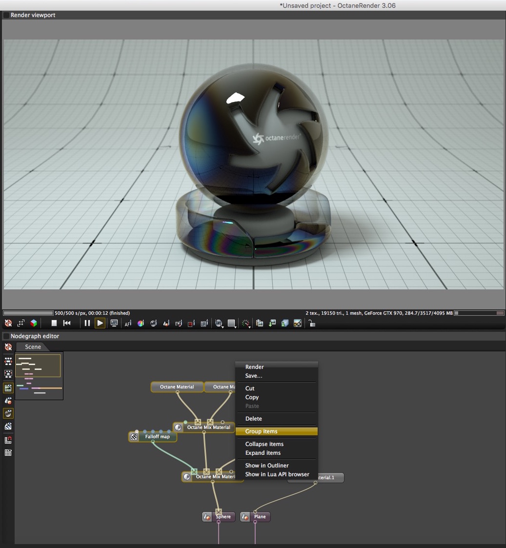

you can only share Materials .orbx files between Standalone and plugins for now, so the first thing to do is to group all the nodes that are related with the material that we want to save:
then you can right click on the group and save al the nodes o the material in LocalDB, LiveDB or .orbx file:
