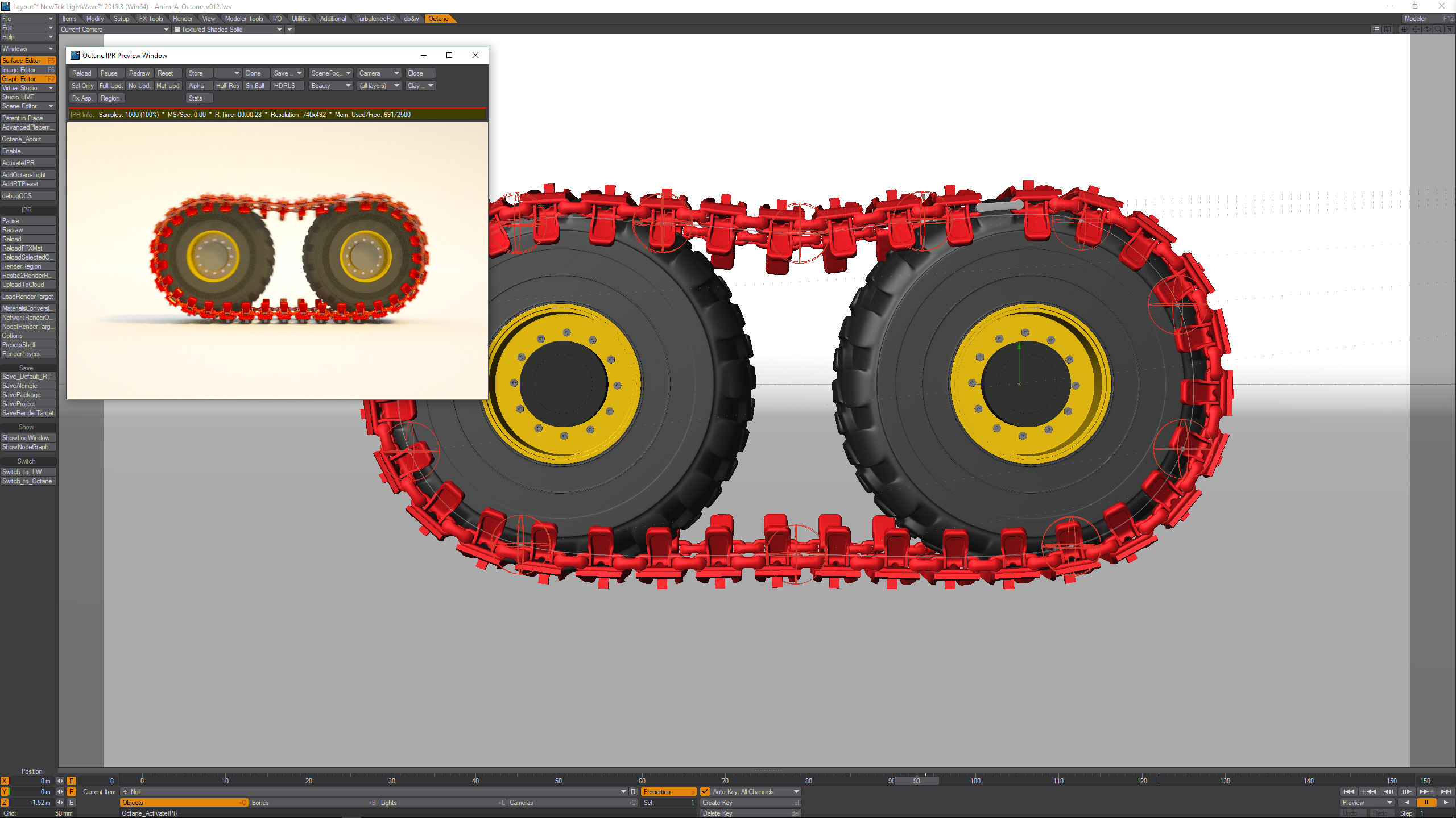

This first image is an IPR render of frame 93 - the track has moved in from the right.

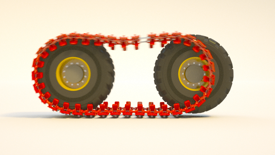

This second image is the F9 render of the same frame - all's well.

Wherever the animation starts, that's where the wheel remains - which is why I assumed it's something I've not set correctly. If I scrub through with the IPR open, all looks fine, but the F10 render leaves the wheel behind from wherever in the animation the render range is set to start. I had started the renders off at frame 0, with the whole track off-screen, which is why the only thing I saw was the tarck moving in attached to only the first wheel - the real geometry wheel.

It is easy ;) The problem is that you are rendering the scene in update mode, but the option to update also the instances is disabled. If you enable it like in the attached image, the instances should be rendering fine.
Thanks,
-Juanjo
