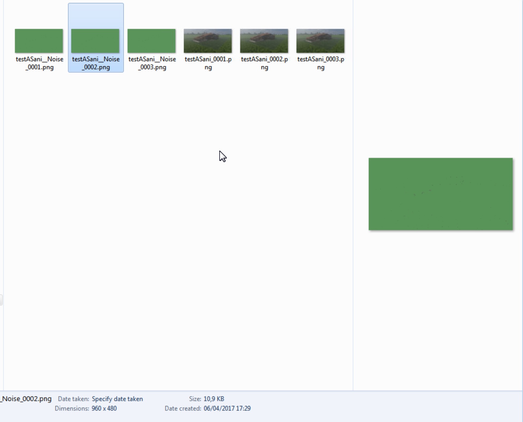

Probably, because you cannot switch back and forth between beaty and noise pass like in LV, you are feeling that AS is not working.
You can enable the noise pass in the Render passes settings and save it, if you see some green pixels, then everything is working as expected:
