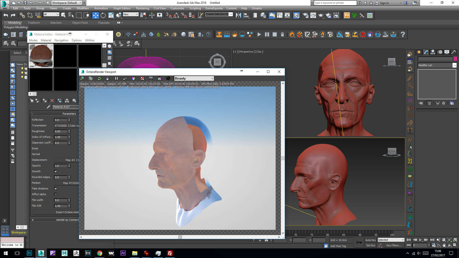

Hello,
i have a strange probleme when i put a displacement map on this object with specular mat.
the back head become transparent.
it doesnt append with a glossy or standard mat.
Any idea please ?
M.°
Octane 3.03.4. -4.21

i deleted the uvs in zbrush.
then uvmaster and reexport the obj and maps.
everithing works now.
i really dont understand why it bug with a specular map.

Hi visionmaster2,
your issue is not dependent on specular material.
It is an issue about normals in your 3D model.
It also happens with glossy or diffuse material, you can check it in geometric normal layer.
Regards
