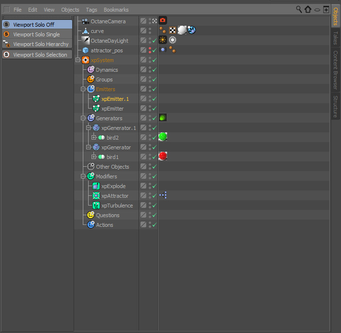

This is the setup :

Using symetry with render instances that's causing wrong calculations in motion engine sometimes. I've converted first symetry to a mesh and worked well.

Thanks. I removed the symmetry node but still had the issue with multiple flocks. However I then removed the octane object tag and it seemed to resolve itself. Its now working as expected with particle systems working in tandem.
Thanks!
