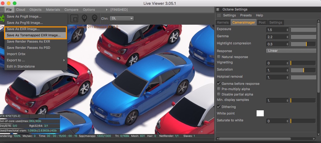

internally OctaneRender always work in linear mode, as said, the camera imager is like the post effect. When rendering in Live View, you can save in both linear mode or Tonemapped mode:

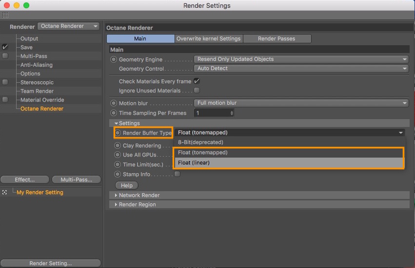

in Picture Viewer for final rendering, you have to choose the output type, Tonemapped or not:
