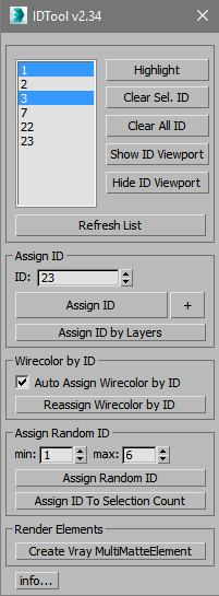

6- We can write or implement ID tool (image below) like known maxscript for octane to setup Render layers with a click of a button.
8- A button to create multiple Octane MultiMatte Elements passes. Automaticly sets up the passes for you..
9- There are various maxscript that enables great workflow like managing ID's (mat or obj) very effectively.
