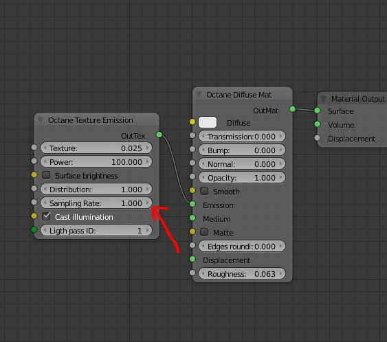

Do you have a scene you could share, as I'm having a difficult time even building a scene with these issues. Here is where the importance sampling is:

grimm wrote:Do you have a scene you could share, as I'm having a difficult time even building a scene with these issues. Here is where the importance sampling is:
The attachment sample-rate.jpg is no longer available

I've tried all possible variations of roughness, and the Texture Emission's Sampling Rate settings don't change anything here...
